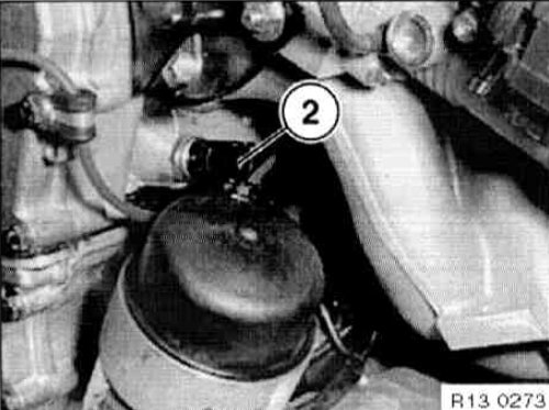

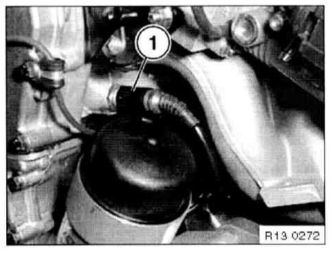

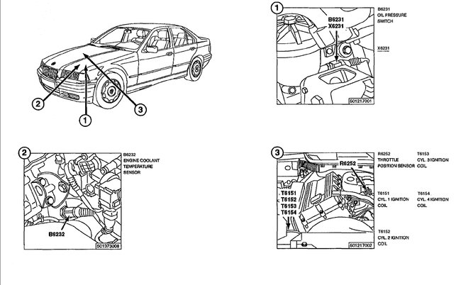

When engine is hot it will not start. it cranks over but not fire into life.
Oct 29, 2017 at 6:03 AM
  • 55,721 POSTS
I would start by reading the codes to see what comes up but to me it sounds like the engine coolant temperature sensor needs to be replaced. Here are some guides to give you an idea of what needs to be done to get us started.
and
https://www.2carpros.com/articles/coolant-temperature-sensor-cts-replacement
Here are some diagrams of what it will take to change the sensor (Below)
