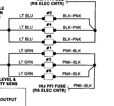

3.1 MFI Will not fire up. I shot fuel into the throttle body and it fired right up, seems that the injectors are not all working, tries to start but barely. Check the wiring to injectors found some smashed, corrected that issue, still same problem. Does anyone have a wire diagram and/or what I should be getting at injectors. Should they have constant power which is what I seem to be getting. Replaced crank sensor, coil packs, plugs, wires, fuel pump, and filter. Does not throw any codes. I did check all wires from computer to injectors for continuity all have it.
Have power to injectors, should they pulse? They only show power constantly.

Sounds like the fuel injectors ground circuit is out-Have the computer tested-

How do I test it myself

Does anyone know what voltage I should be getting at the injectors and which wires and colors to test. A diagram would be great

Look you have low fuel pressure you have to fix that first. A faulty fuelpump check valve will cause what you are experiencing.
A faulty in-tank fuel pump check valve will allow fuel in lines to drain back to tank after engine is stopped. To check this condition, turn ignition off, disconnect fuel pressure line at fuel rail, remove filler cap, and connect a radiator test pump and apply 15 psi (1.0 kg/cm2 ) pressure. If pressure will hold for 60 seconds, check valve is okay injectors have 12.2ohms resistance. Besides you need wha tis called a noid light to test injectors not a probe. Here is injector wiring colors
