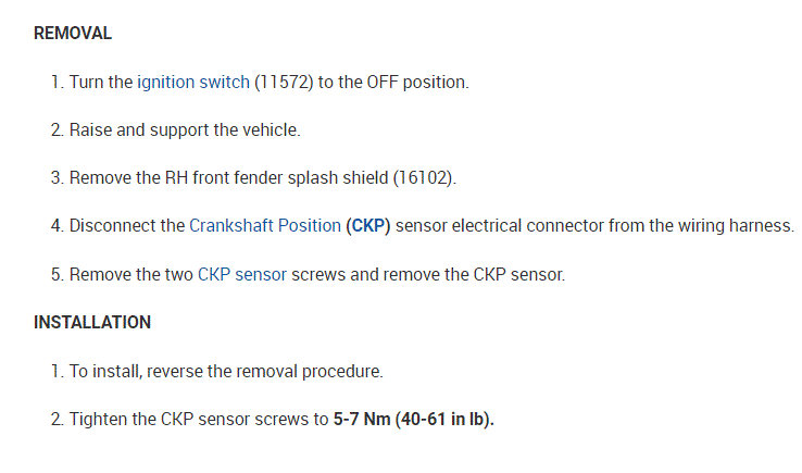

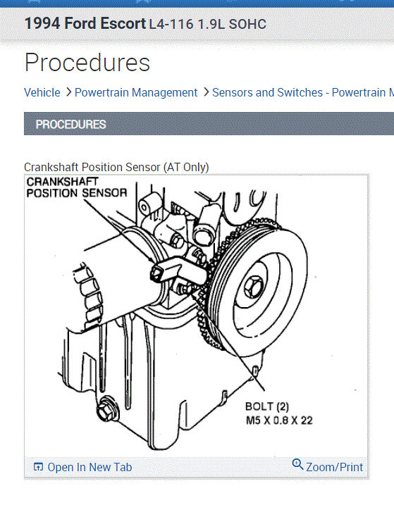

Thought it was a fuel problem, changed pump, screen, filter and fuel pressure control, fuel pressure is 35 PSI... no spark, but was starting with starting fluid. Now I cannot start it all even with starting fluid. Has no spark. Has new coil pack, installed 4 months ago.

If there is no spark, there is a good chance the crankshaft position sensor has failed. Take a look through this link and let me know if it mirrors what you experience.
Also, you can pull diagnostic trouble codes to help confirm. Here is a link showing how that is done on this vehicle. You do not need a scanner.
https://www.2carpros.com/articles/ford-lincoln-mercury-obd1-1995-and-earlier-diagnostic-trouble-code-definition-and-retrieval
If you do this, let me know what codes are found.

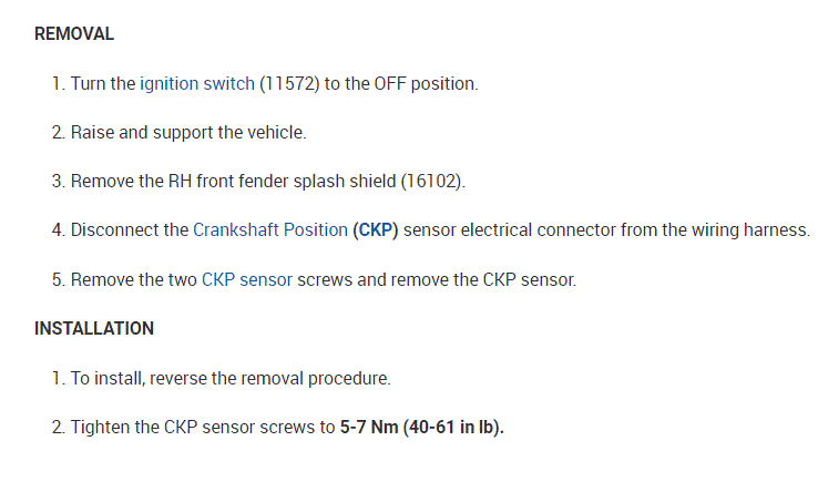

If you do find it is the sensor, here is a link that shows in general how it is replaced:
If you look at the attachments below, they include the directions and pictures specific to your vehicle.
