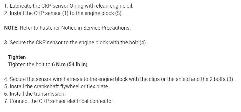

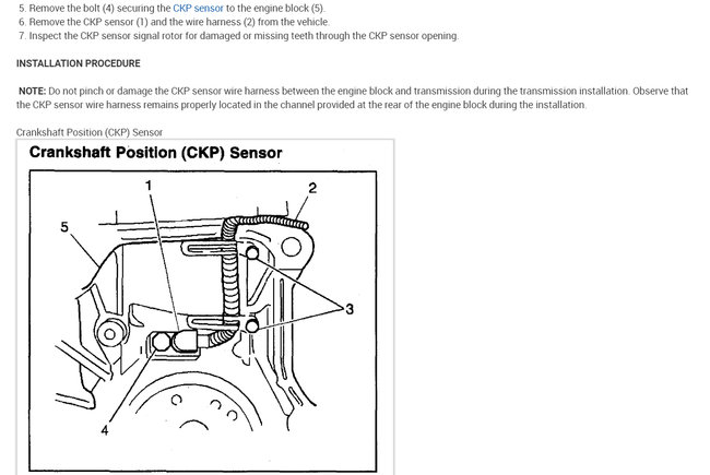

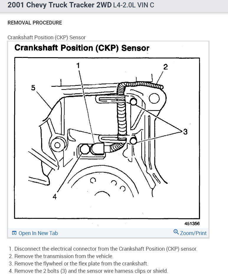

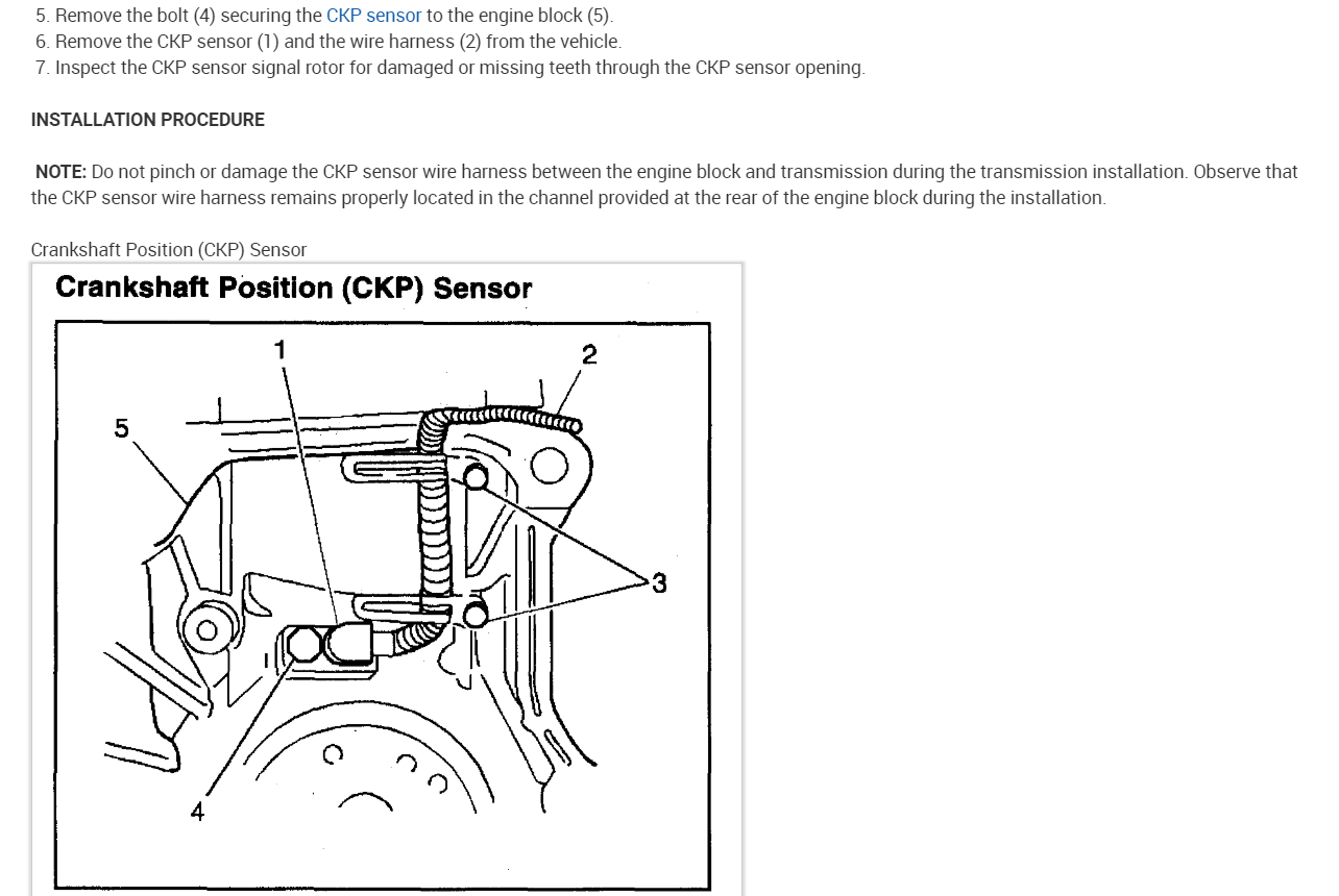

It sounds like a crankshaft angle sensor which when that go out they do not leave a code. Here is a guide to walk you through the repair and diagrams and instructions below to show you on your car:
