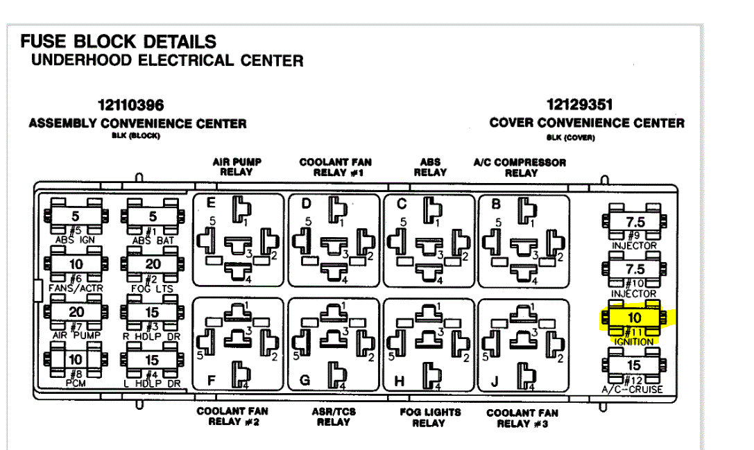

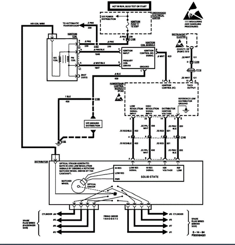

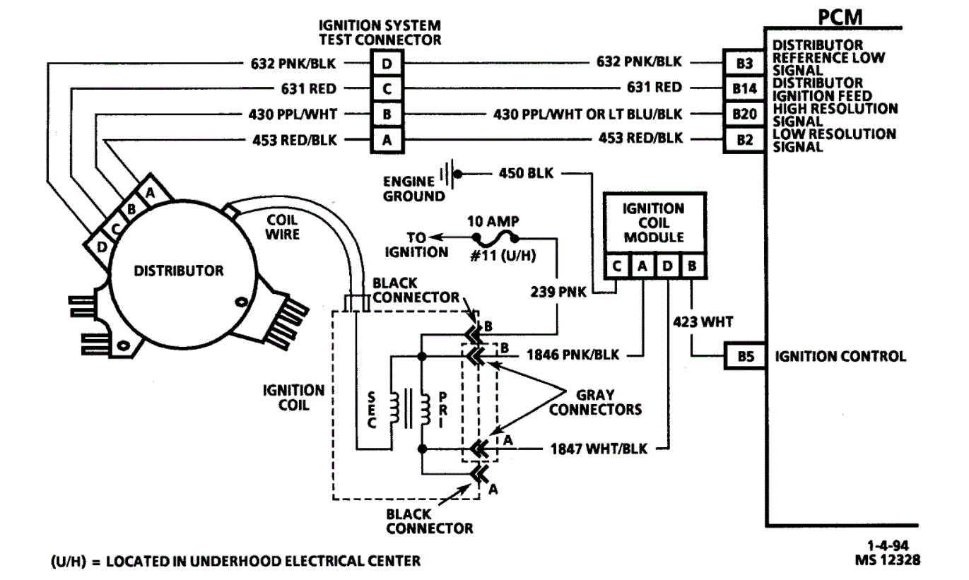

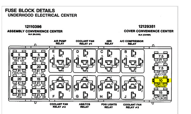

I attached a couple of pics below that you may find helpful. One other thought. Did you check the 10 amp fuse in the under-hood fuse box (fuse 11) that is specific to the ignition? Also, have you checked the ignition control module?
See pics below. Also, pic 3 shows the fuse I'm referring to. When checking, make sure there is power both to the fuse and from it.

Fuses are all good and reseated. The ICM is brand new but put the old one back in just in case, but no change, just a continuing turnover. There is spark going to the coil but none out! Testing negative post and one on the positive post of the coil results in 1.5ohms. Put the old coil back just to try. Checking both from side terminal and one in the center high tension terminal gives just above 8k ohms. One change has occurred when the key is turned on - security lights up and then goes out and the check engine light stays on. I borrowed a reader. I plugged it in and turned the key on. The reader goes through a self-check, checks the VIN and starts counting in percentages, quitting at 50% and displaying error message that it cannot continue - no other message. I am truly stumped. I got the PCM (flashed to my VIN) from FlashMasters off eBay. When I got it, plugged it in and the car fired right up, took it for a 10-15 minute ride and noticed the car did not get up to power and idled rough and would shut off. Pulled into the garage waiting on the new fuel pump. After the fuel pump was installed is when it wouldn't start. Stumped!

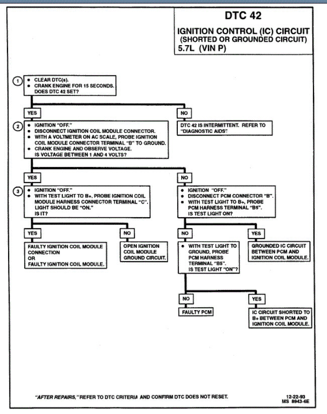

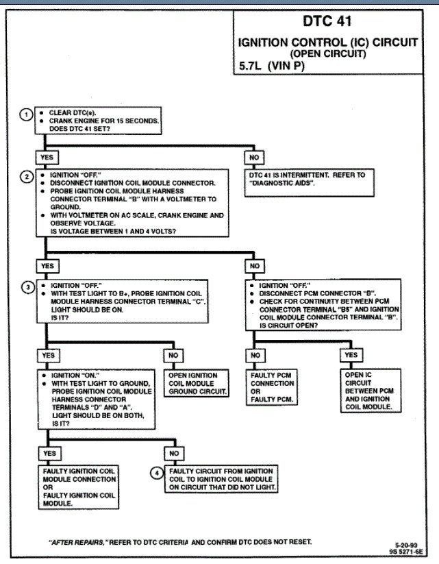

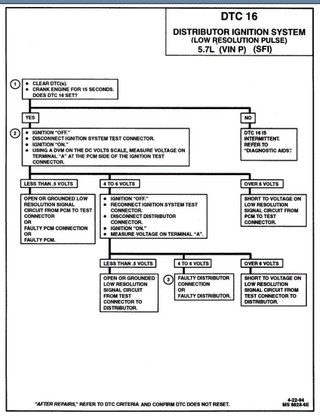

Just for the heck of it, take the distributor cap off and have someone crank the engine. See if the rotor moves. Also, resistance seems high on the coil. If I recall, 1 ohm should be max.
Also, take a look at the three pics below. Each one is a different diagnostic flow chart. Each of these three codes can cause a no-start condition due to spark.
You are certain the fuel pump is running, correct?
Let me know if that helps in any way.
