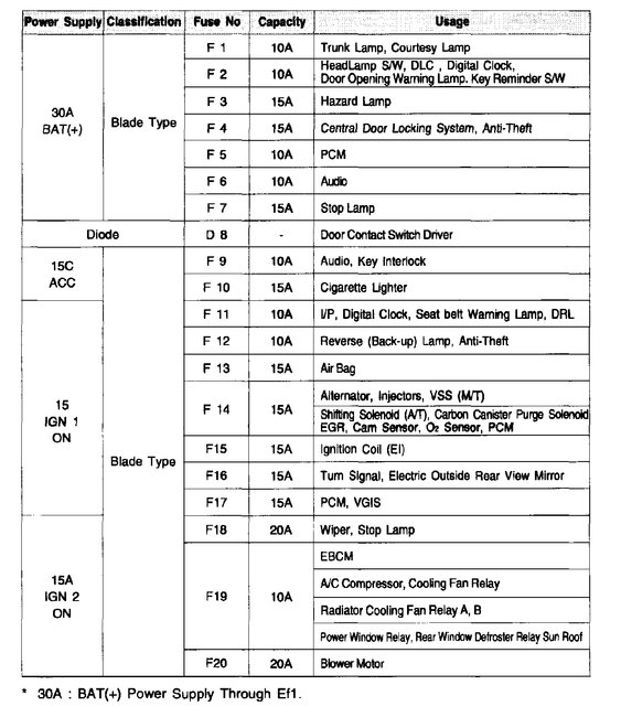

No spark and no fuel pressure, cranks okay.
May 11, 2019 at 8:14 AM
Experienced Mechanic
110,248 POSTS
Welcome to 2CarPros.
First, here is a link that discusses the most common reasons for a crank no start condition. Take a look through it.

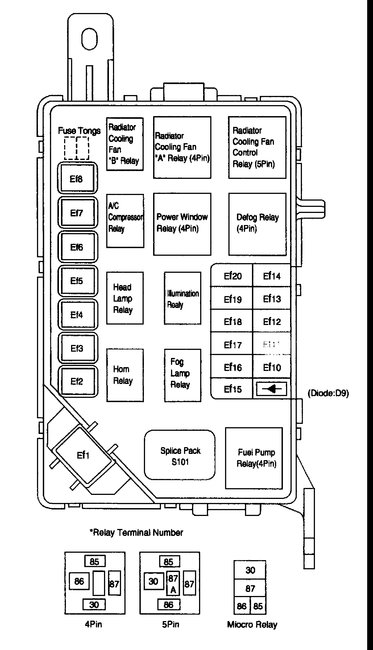

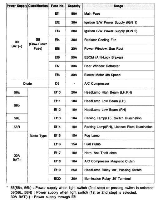

The first things I need you to check will be simple. I need the fuel pump fuse and the ignition fuse checked. The fuel pump fuse (Ef16) is under the hood in the power distribution box. See pictures 1 and 2. Confirm it is good.

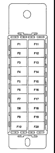

Next, I need you to check ignition coil fuse f15 in the interior fuse box. See pics 3, 4, and 5.
Here are a few links you may find helpful when testing the fuses and for power:
Let me know the results.
