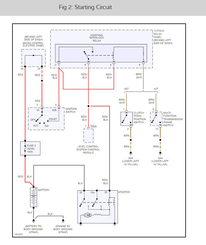

Okay cool, when trying to crank the car over do you see the security light flashing? If so here is a guide to help reset it:
https://www.2carpros.com/articles/how-to-reset-a-security-system
If not lets check for power at the starter solenoid by using this guide.
Here is the starter wiring diagrams so you can see how the system works. Check out the diagrams (below). Please let us know what you find.

Well, I checked out the all-road with the starting problem. I load tested the battery witch is good and starter works and it's getting fuel and spark it cranks but does not start. that tells me it could be the crank positioning sensor.

Okay, so the engine is turning over, except it isn't actually starting correct. If it is getting fuel and it has spark it isn't likely the crank sensor as a bad crank sensor would shut off fuel and spark. It's possible that it is a cam sensor as that controls timing in the spark and fuel systems. However they rarely fail just setting still. I would check all of the connections for corrosion or damage first. I would also look for rodent damage. What test equipment do you have access to?
