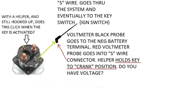

Car will not start. Will not turn over to start. Changed fuel filter, new battery, charged battery. Try to start with battery charger. When changing fuel filter, filter had fuel in filter. Still will not start.

Battery charge good. No corrosion or loose cables, wires. Fuses good. What solenoid? EGR? Where is solenoid you are referring to? How do I check it if it is good?

In ancient times, this was called the solenoid or starter solenoid. (nowadays it is often called a "starter relay")
https://shop.advanceautoparts.com/web/PartSearchCmd?storeId=10151&catalogId=10051&langId=-1&pageId=partTypeList&actionSrc=Form&searchTerm=starter%20solenoid&vehicleIdSearch=8340
You have a 5.0 Liter? (Not a 4.6)
Do you have a voltmeter or 12 volt test light?
We might be able to narrow down where the issue might be.

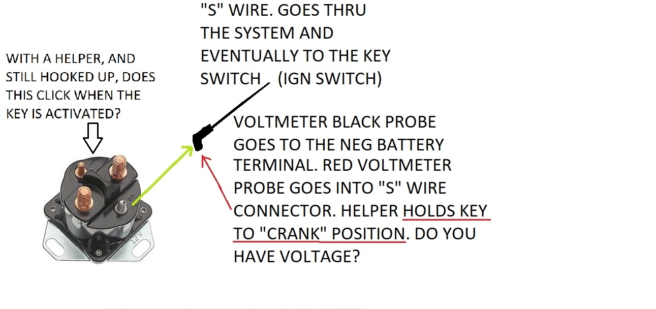

Have you tried this?
See my picture.
