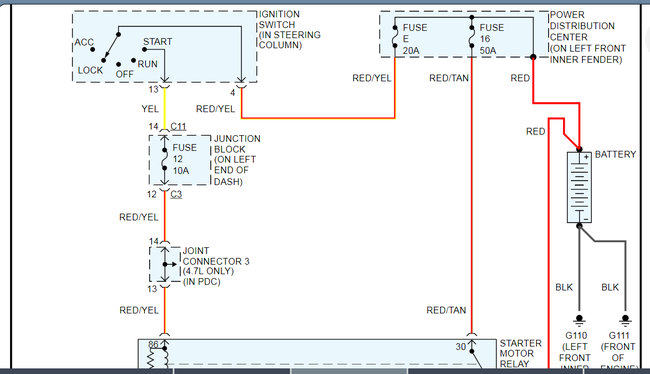

Will turn over but not start
2003 DODGE DURANGO
200,000 MILES • 4.7L • V8 • 4WD
LAURAJOHNSTON
First time this has happened. small leak in coolant hose near firewall.
Nov 23, 2019 at 3:13 AM
SCGRANTURISMO
  • 4,897 POSTS

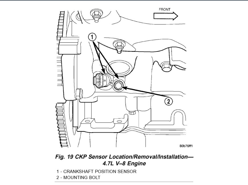

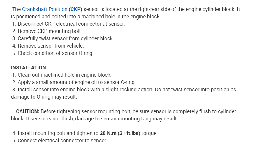

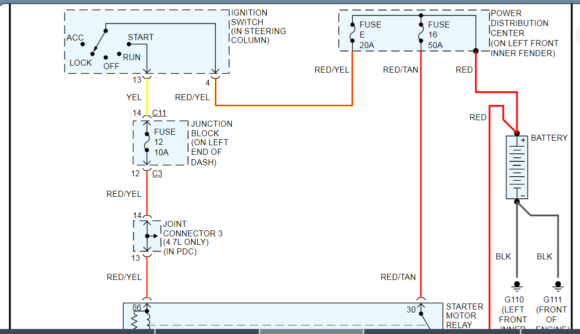

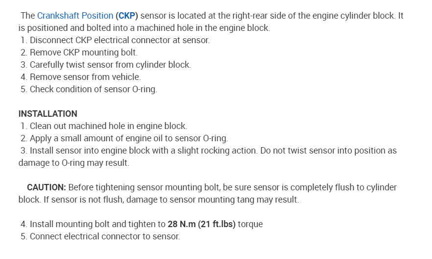

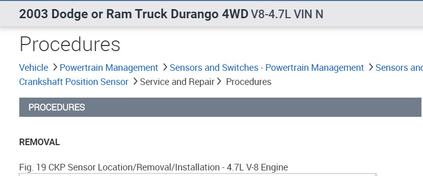

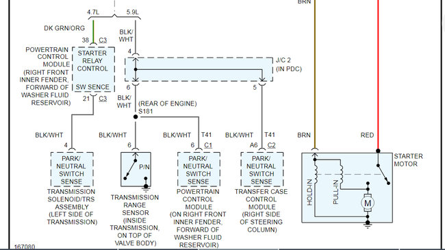

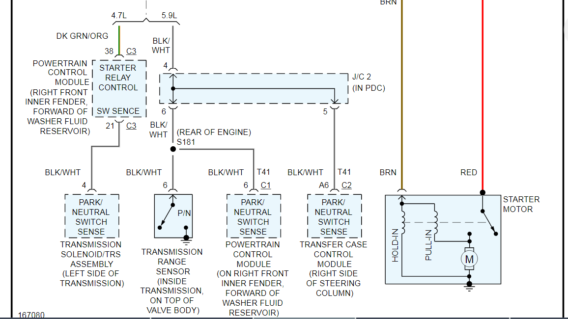

This could be a problem with your vehicle's Crankshaft Position Sensor [CKP] which is used by your vehicle's PCM to synchronize the fuel injectors and the spark timing. In the diagrams down below I have included the wiring diagram of your vehicle's starting circuit along with instructions for the removal and installation of the CKP sensor. Here is a generic link to a guide explaining how to replace a CKP sensor down below:
Please go through these guides and get back to us with how everything turns out. We can go from there if necessary.
