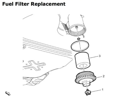

Check that the in tank fuel pump is energized. Suggest to remove the feed pipe from the diesel filter, insert it in a container. Crank the engine and see if fuel is being supplied,
A more accurate reading would be by using a manual fuel pressure gauge, attach it to the pipe and see what pressure is being produced. we should see between 414-483 kPa (60-70 PSI).

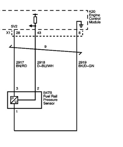

Check connector and wiring to the rail pressure sensor.
Using a multimeter check for 5V supply and ground
Pin 1, black/dark green wire ground
Pin 3, brown/red wire 5V with ignition on

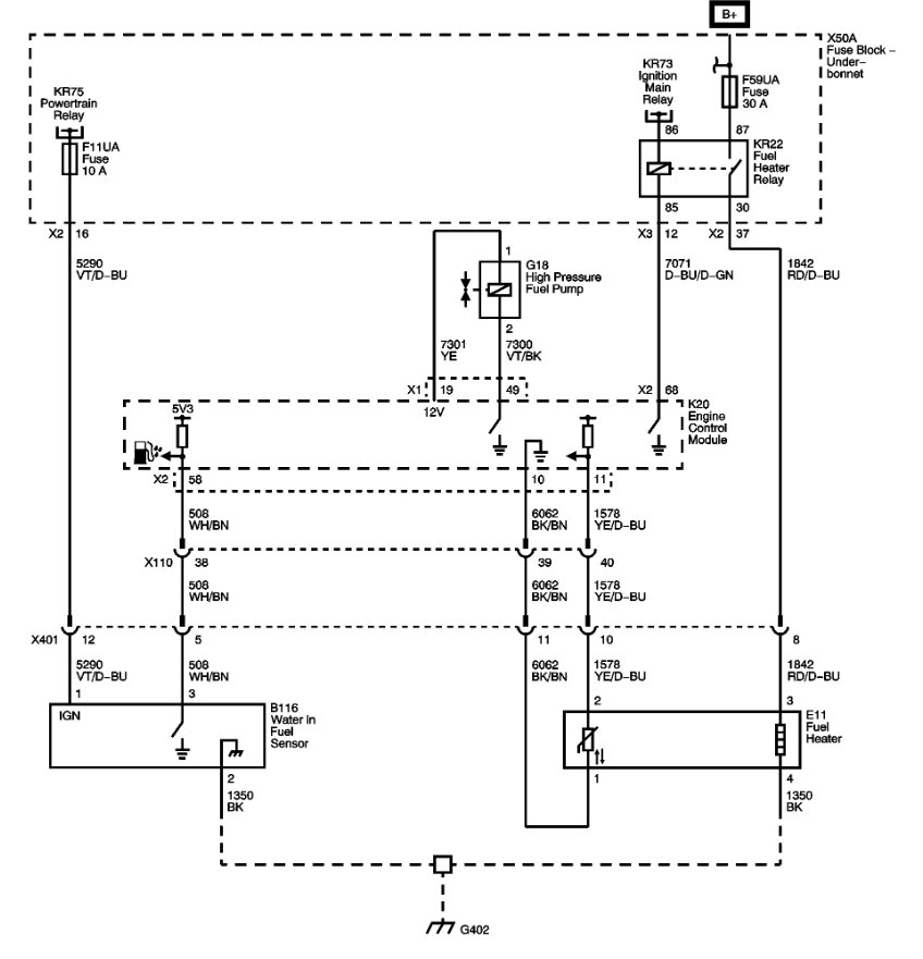

Check wiring to fuel pressure sensor(G18)
Pin 1, yellow wire 12V
Pin 2, violet/black wire ground
See wiring information in images 1+3 below
