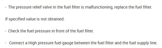

car cranks fine starts for one second shuts off cranks fine but will not start.

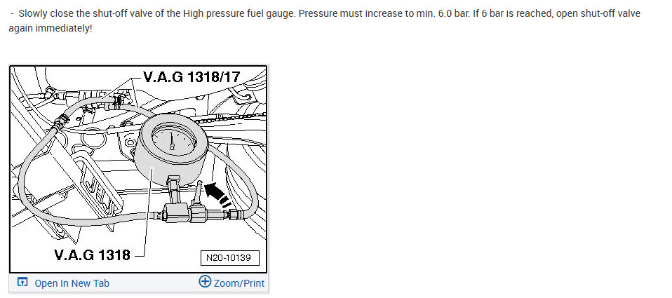

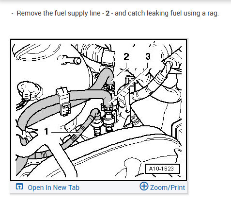

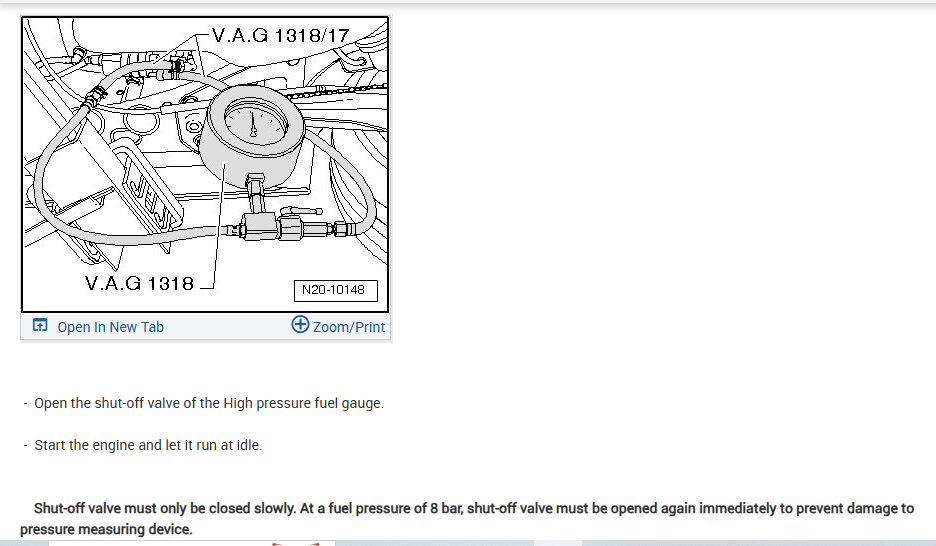

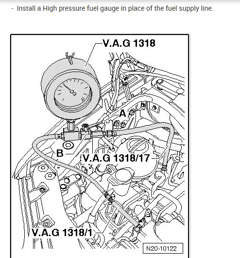

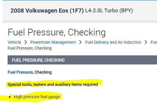

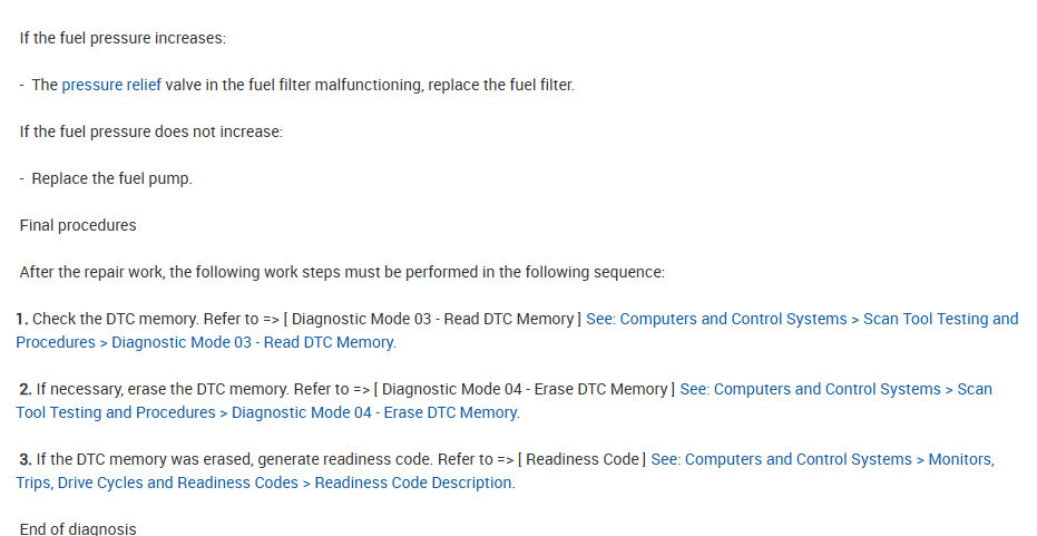

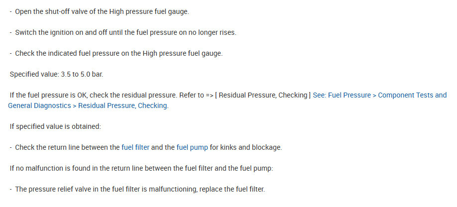

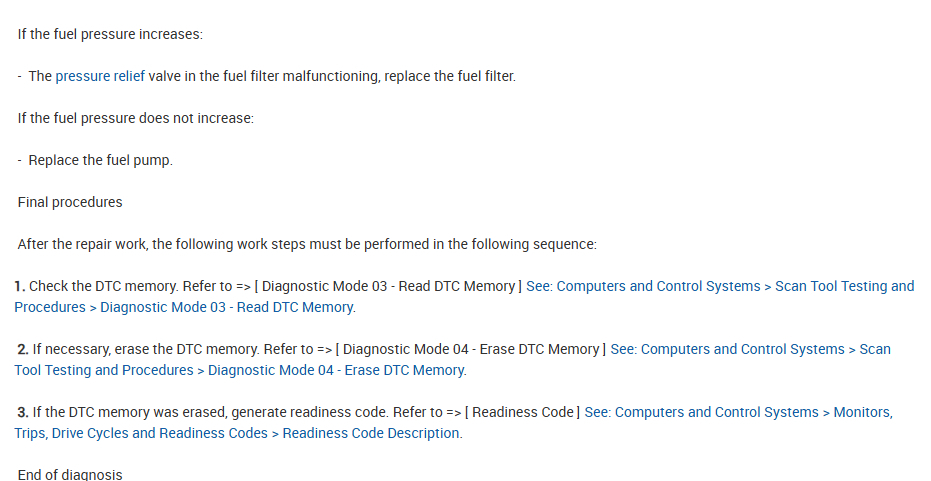

Since it does start, the first thing I would suggest is to check the fuel pump pressure to the engine. If you haven't already, that is where I would start.
I attached the directions for testing below. Take a look through them and let me know if you have questions.
