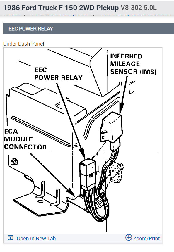

There is a wht/ltblu wire going to the EEC relay. When the key is on it should have power. It sounds like the ignition switch is bad if you don't get power. Here is a guide to help and the location of the EEC relay:
Jan 3, 2024 at 2:10 AM
RANDY ISBILL

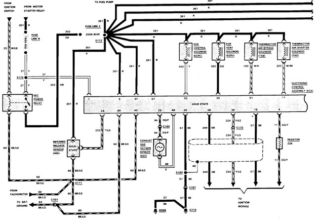

Well, the EEC relay pulls in, the DK BL has no power going out because its burnt in2. So I chased the wiring from the fuel relay and low and behold found a red one with no insulation on it for about 4 inches, it was arcing to the valve cover, so now I need to find a under the hood diagram before I go any further. Thanks for guiding me to the relay, it helped a ton.
Jan 5, 2024 at 8:21 AM
  • 55,447 POSTS

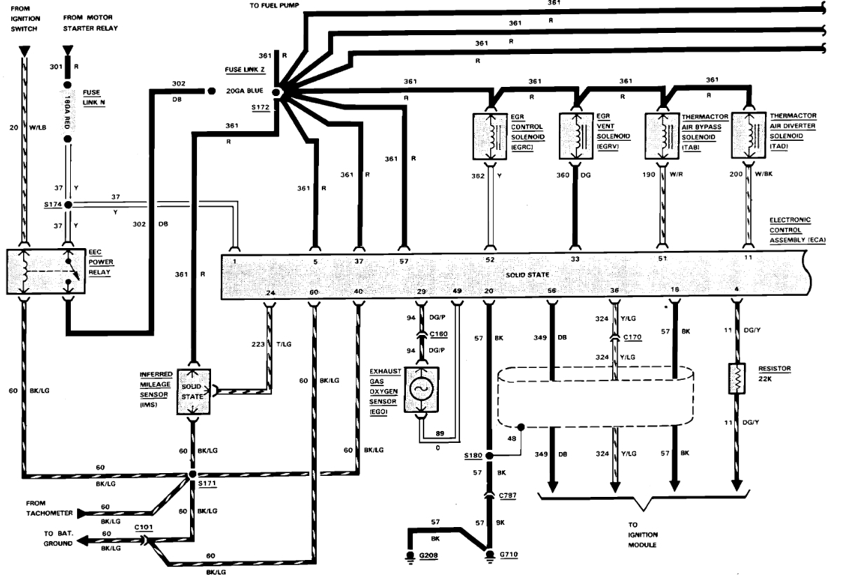

Sure, here you go, and I have included a guide to help with the testing as well.
Jan 7, 2024 at 2:00 AM
RANDY ISBILL

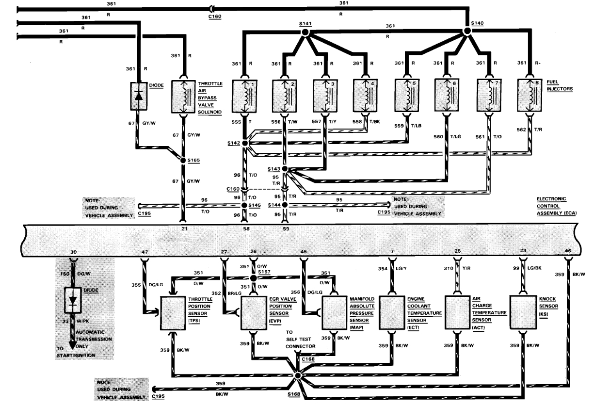

The wire to the EEC relay was broken inside the jacket, repaired it. Found several burnt wires in the harness under the hood, replaced those. My fuel pumps work now, I have very good spark, have good fuel pressure in the rail but I also have 12.1VDC on both wires on all injectors. I unplugged each one and checked them to ground and both had 12 volts. How does that happen??
Mar 28, 2024 at 11:35 AM
  • 55,447 POSTS
To confirm all of the injectors are unplugged when testing, correct? The engine computer grounds the injector for its operation. If any of the injectors are still plugged in this will happen. Please let me know.
