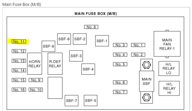

3 weeks ago, the car would not start. Turned over yet sounded like no fuel. Prepped car to do fuel pump. Disconnected the negative cable on battery and removed fuse. I bought said fuel pump. Decided to reconnect and try it. It started up. Now, it won't start. sounds the same when trying. Also, in btwn and prior to all this. The car never stalled and showed 0 signs of fuel pump issues.

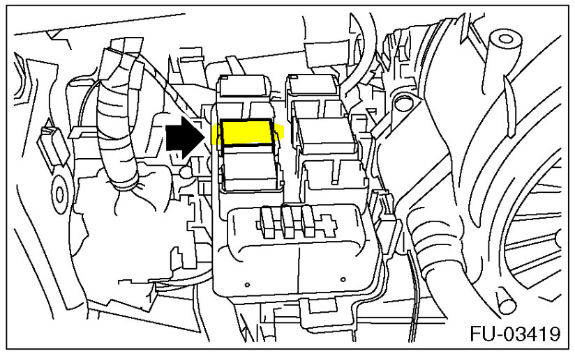

Also, if you haven't already, check the fuse and the fuel pump relay to make sure it isn't failing. The fuse is fuse 11 in the under-hood fuse box see pic 2 below. The fuel pump relay is located in the relay block on the back side of the glove box. See pic 1
Let me know what you find.
