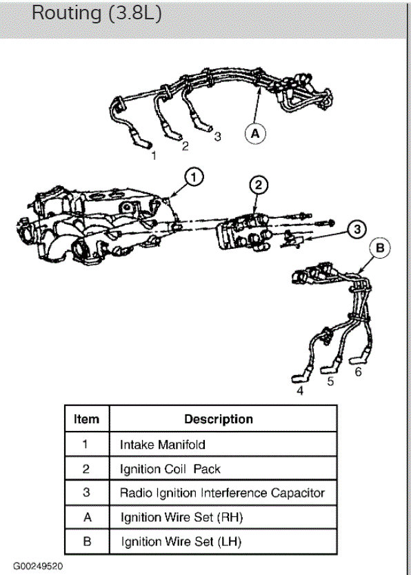

I lost power in the engine. I replaced the Ignition Coil pack because I had 3 misfires. Now engine will crank over but will not start. Fuel pump comes on battery is good.

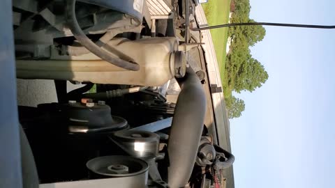

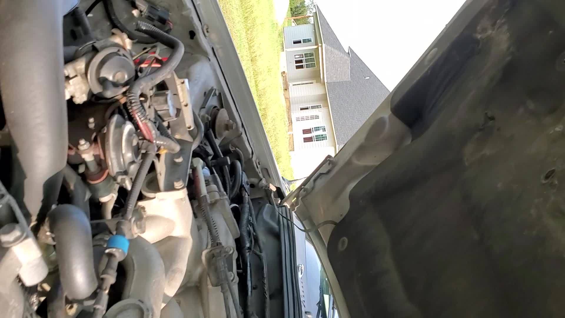

This is what it is doing.

I listened to it. Is the battery fully charged? If it is, it sounds like the timing is off. Note how it cranks and hesitates and then cranks again. Usually, that is caused by an ignition spark that is too early.
Are you certain that the spark plug wires were reinstalled to the correct cylinders? See pic 1. I have a feeling that is what is causing the problem.
