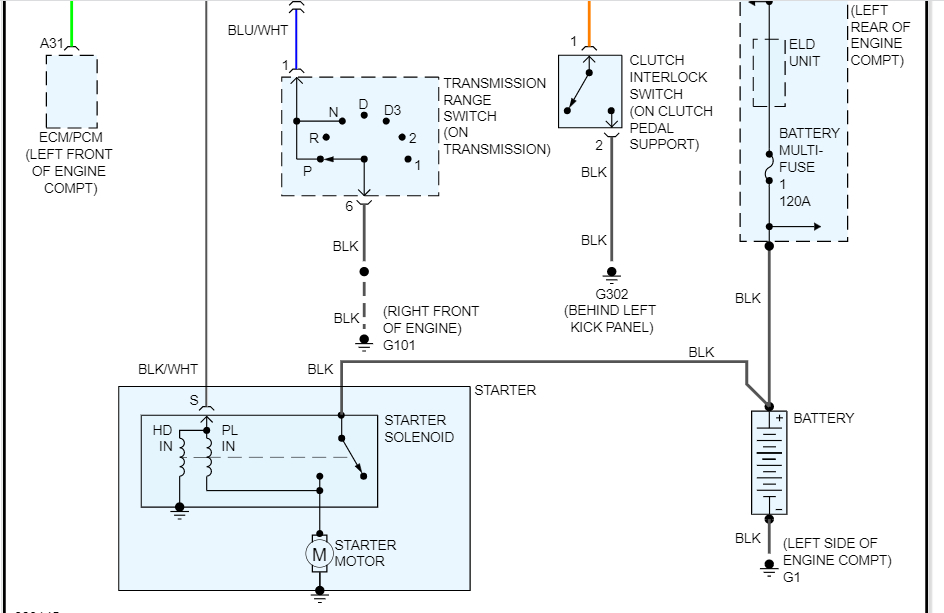

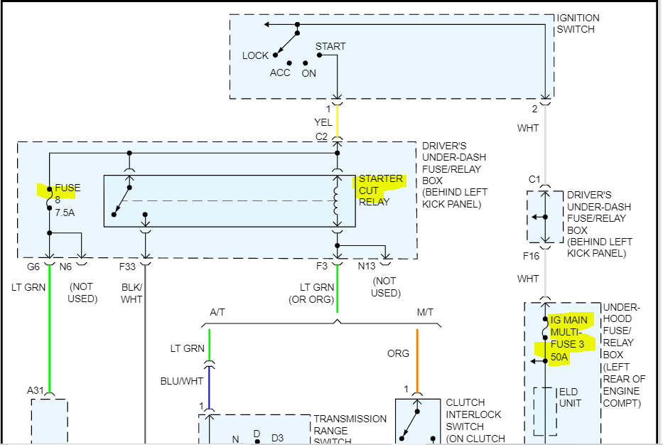

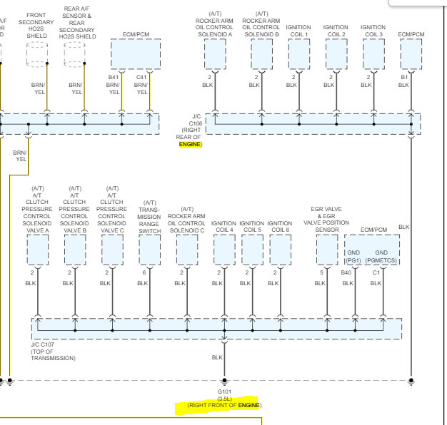

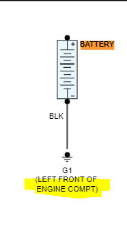

Okay, I need you to check the ground from the battery to the left front of the passenger compartment and the right front of the engine. Something was damaged or loosened when you had the valve covers off. (See pics one and two)

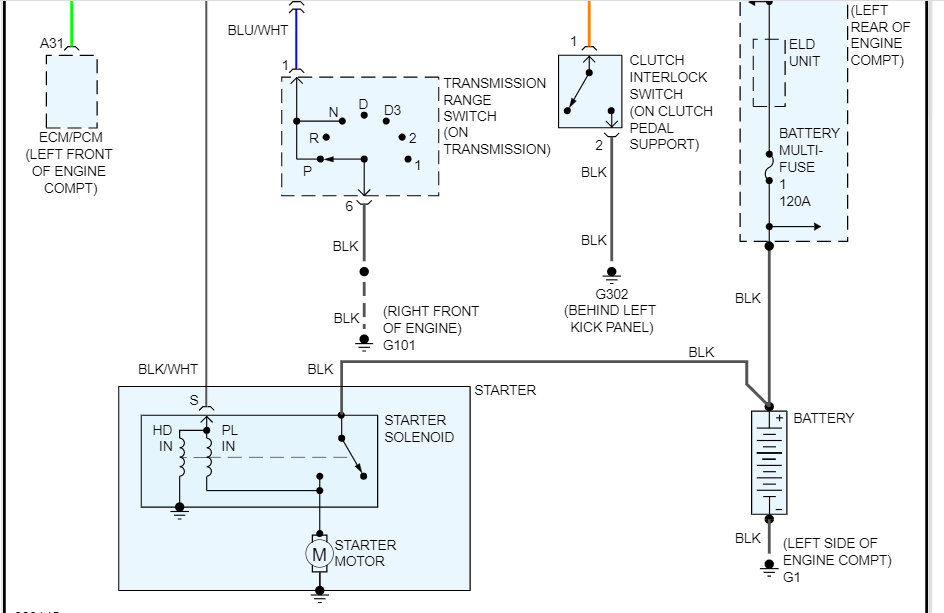

Also, I attached the wiring schematic for the starter. Take a look through pics three and four and confirm the fuses and relay are working properly.
When you check a fuse, you are actually looking for two things. First, is the fuse good? Second, you need to make sure there is power to and from it.
Also, please confirm for me that the click is from the starter and not a relay.
See pics below. Note: I had to cut the wiring schematic for the starting system in half to make it readable for you. I did overlap the two so you can follow from one to the next.
