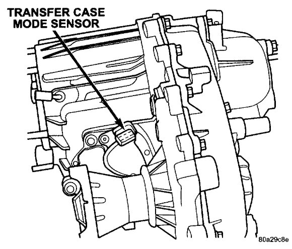

the #1 failure on these trucks: bad 4wd mode position sensor (internal to transfer case), also I have seen the control switch go bad as well, and finally there could be a bad ground, last resort. Also, lets double check the fuses:

Here is the location of the sensor switch, check out the images (below). Please let us know what happens.
