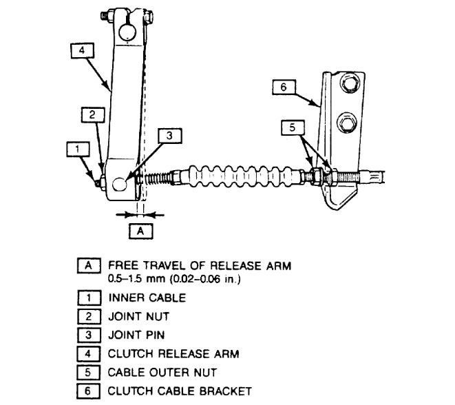

Will not shift from first gear
1994 GEO TRACKER
76,000 MILES • 1.6L • 4 CYL • 4WD • MANUAL
JIMMYBRADY6
My vehicle will only drive if started in first gear, and has to be shut off to stop. Thinking this is a clutch or possibly a throw out bearing issue. Anyone else have this issue or know what it could be? Thanks
Feb 14, 2020 at 1:23 AM
Good afternoon,
Yes, it could be a clutch issue but does the clutch pedal feel any different fro before?
This could be a bad cable from the clutch pedal to the transmission. You can try adjusting the cable to see if it helps. I attached the procedure for you.
https://www.youtube.com/watch?v=ydXqRMFzXOQ
Feb 14, 2020 at 3:41 AM
