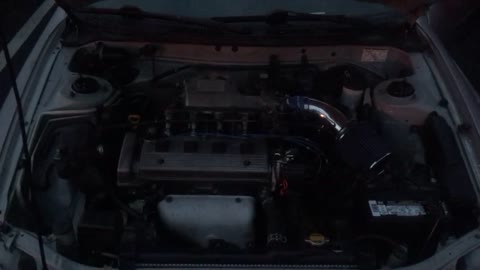

On my way to work my car completely shut off while I was driving it. I realized there was no oil in it, put oil in it and still wouldn’t start. I replaced the ignition distributor, got a new battery because old one was bad, replaced the spark plugs and it will start now but anytime I attempt to drive it out of the parking spot, it shuts off the car. There is no knocking sound to indicate the engine is seized or locked up (plus it wouldn’t be able to start otherwise) and no matter how much I rotate the new distributor, it idles rough and it doesn’t idle like it would normally. It’s almost as if when idling the RPMs slowly go down as it continues running in place. I don't know if it could be the transmission possibly?

How low was the oil? Have you checked for codes? Here is a link showing how it's done on this vehicle:
https://www.2carpros.com/articles/toyota-trouble-code-definitions-and-code-gathering-method-1990-1995
If you haven't checked codes, do that and let me know what you find.

I have checked codes, only code (I can’t remember the number since it’s OBD1) is for the front right ABS speed sensor because there’s something with the cruise control that’s messed it up, but that wouldn’t cause the current issue. The oil was pretty much almost dry, but the engine didn’t seize up because it’ll start and move about a foot when I attempted to drive it but then it’ll just shut off. I did attempt to adjust the ignition distributor to see if that would help the idling RPMs but it didn’t do much. My friend said it could be the timing belt or needs a timing adjustment but there’s no slapping sound to indicate that the belt snapped.

Can you do me a favor? Record the engine starting, running, and then stalling. Upload that for me so I can hear it.

So when I went to go try and start it this time it wouldn’t start at all again. A friend suggested the timing is off.

It doesn't sound like a timing issue. When it does that, see if it starts for a couple of seconds using starting fluid. If it does, then we know it is a fuel related issue. If it doesn't, then it is likely ignition.
