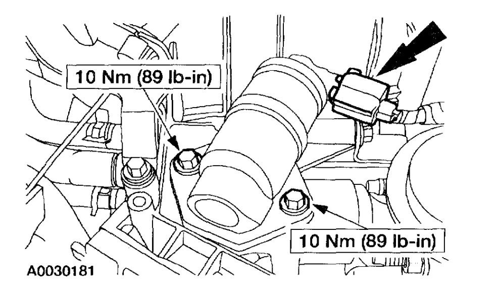

Good evening,
The idle is controlled by the idle air control valve and the throttle body.
https://www.2carpros.com/articles/how-to-replace-an-idle-speed-control-motor-iac

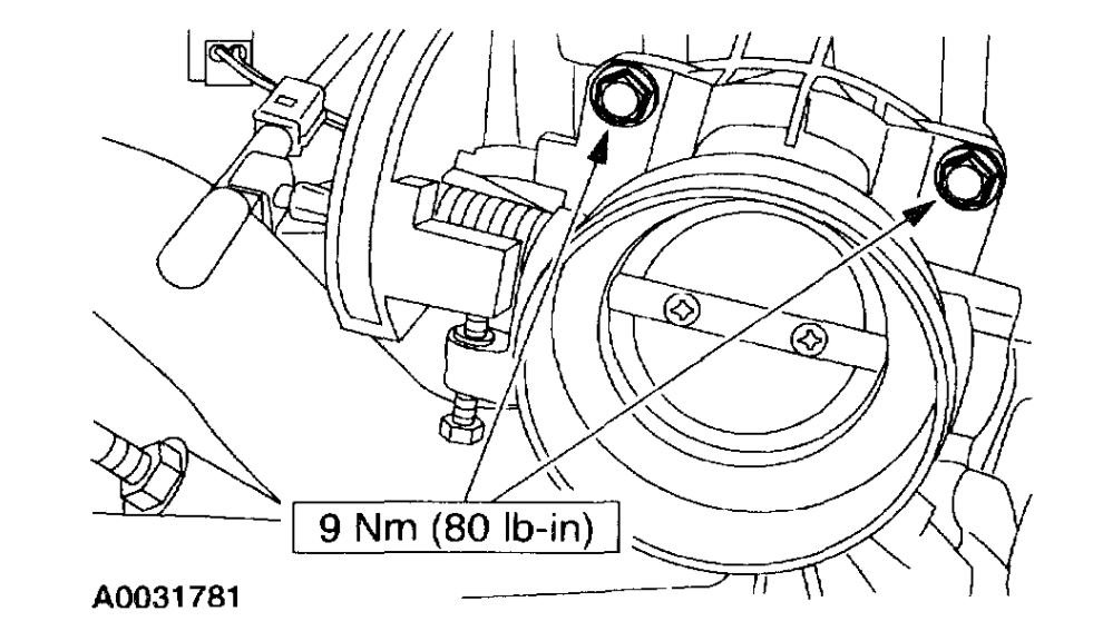

Make sure the throttle is clean of all carbon. The base isle with the IAC disconnected is 500 RPM's. With the IAC hooked up, it should be 650 RPM's.
REMOVAL
1. Remove the accelerator control snow shield.
2. Disconnect the electrical connector. Remove the bolts and the Idle Air Control (IAC) valve.
INSTALLATION
1. To install, reverse the removal procedure.
NOTE: Install a new IAC gasket.
