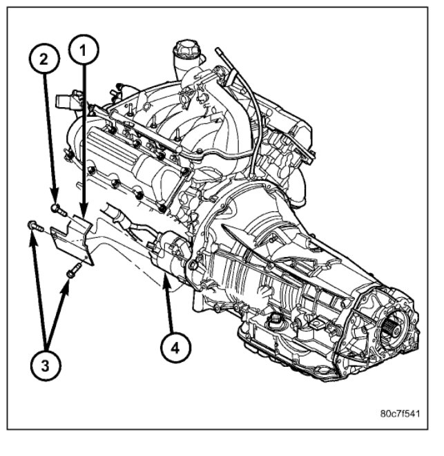

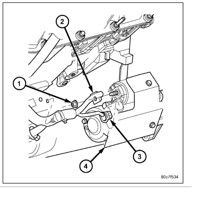

Parked car for twenty minutes turned switch all lights come on, I can hear fuel pump engage but nothing happens, no clicking, battery good. all accessories work.
Oct 23, 2017 at 2:50 AM
  • 55,748 POSTS
Is the security light flashing when this happens? If not then I would first check the starter by testing the trigger wire when the key is in the crank position.
Here is a guide to help show you, check out toward the bottom of the guide.
If the starter dos test bad here is a guide to help you see what you are in for when doing the job.
To jack you car up for the test and the replacement
Here are some diagrams of what it will be like for your car (below)
