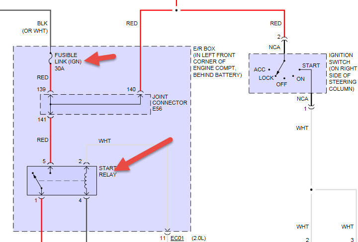

Will not crank. Just rapid clicking sound.
2005 HYUNDAI TIBURON
50,000 MILES • 2.0L • 6 CYL • 2WD • MANUAL
GRANDDAD
Battery and fuses checked all are OK, Starter and battery ground wire replaced.

was battery checked for load test? check items in pic for being bad if all ok try jumping car . if car starts with a jump then get battery load tested most places do for free. finally try resetting security system. if no manual look online

forgot pic.
