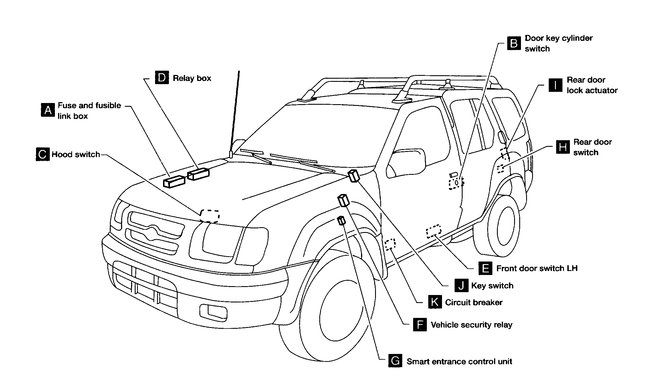

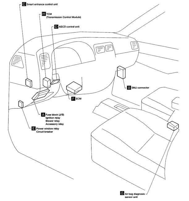

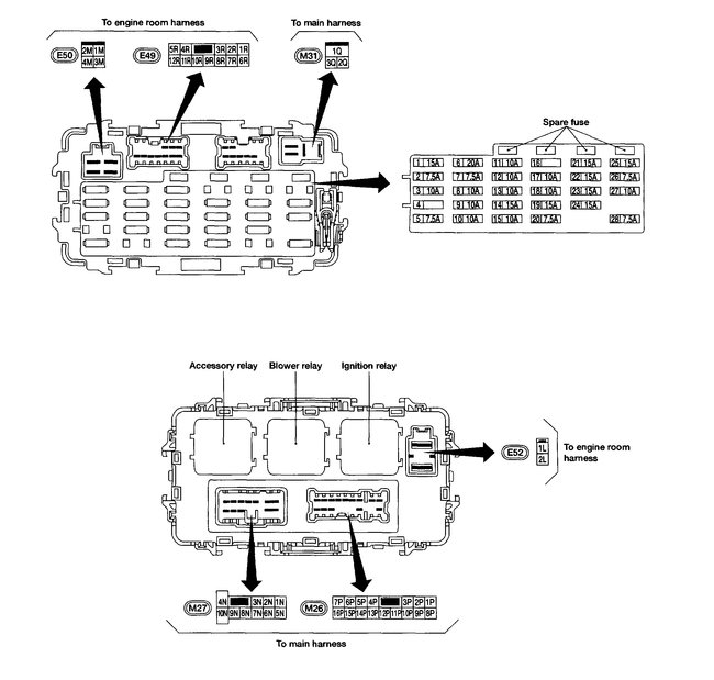

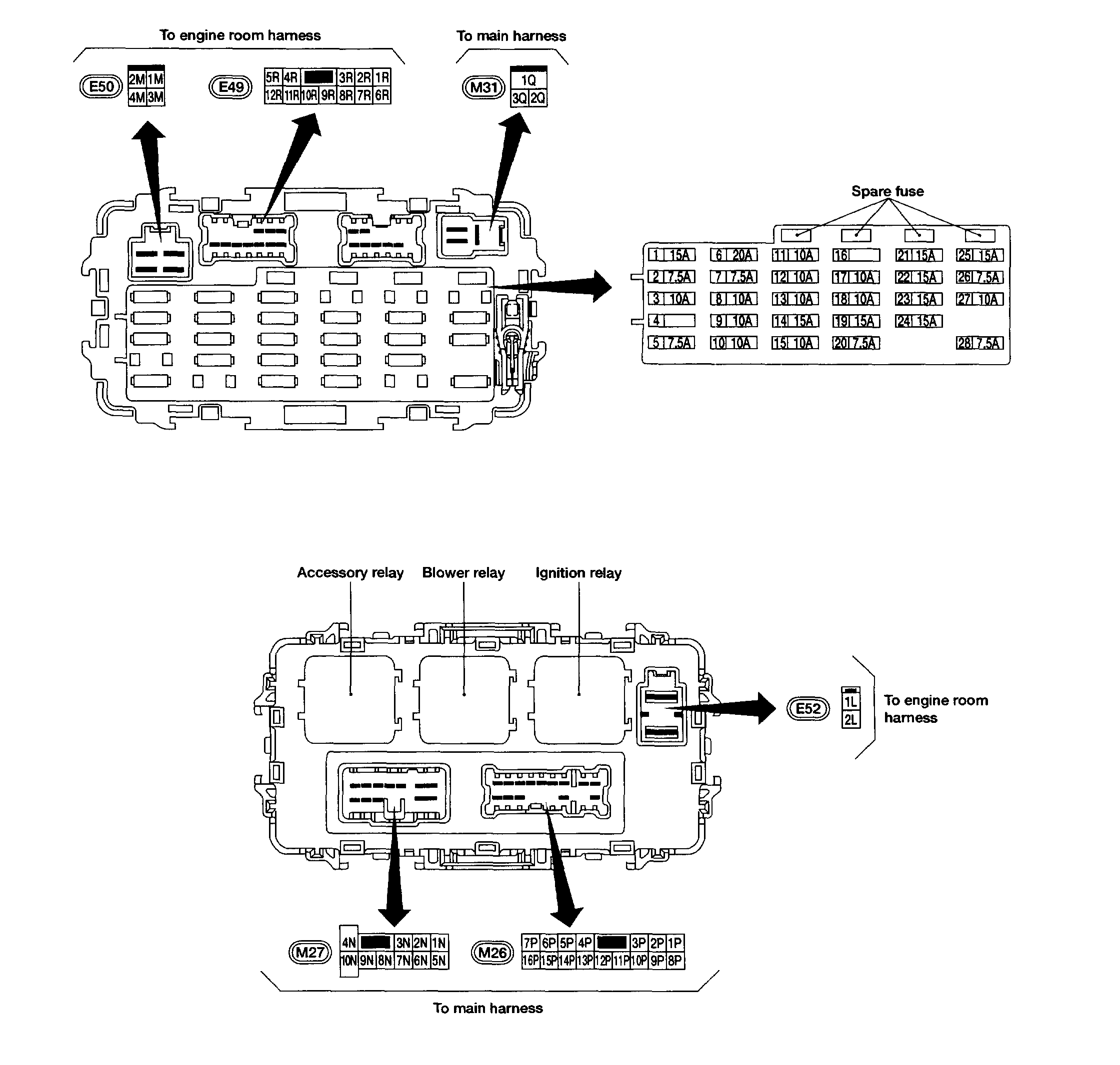

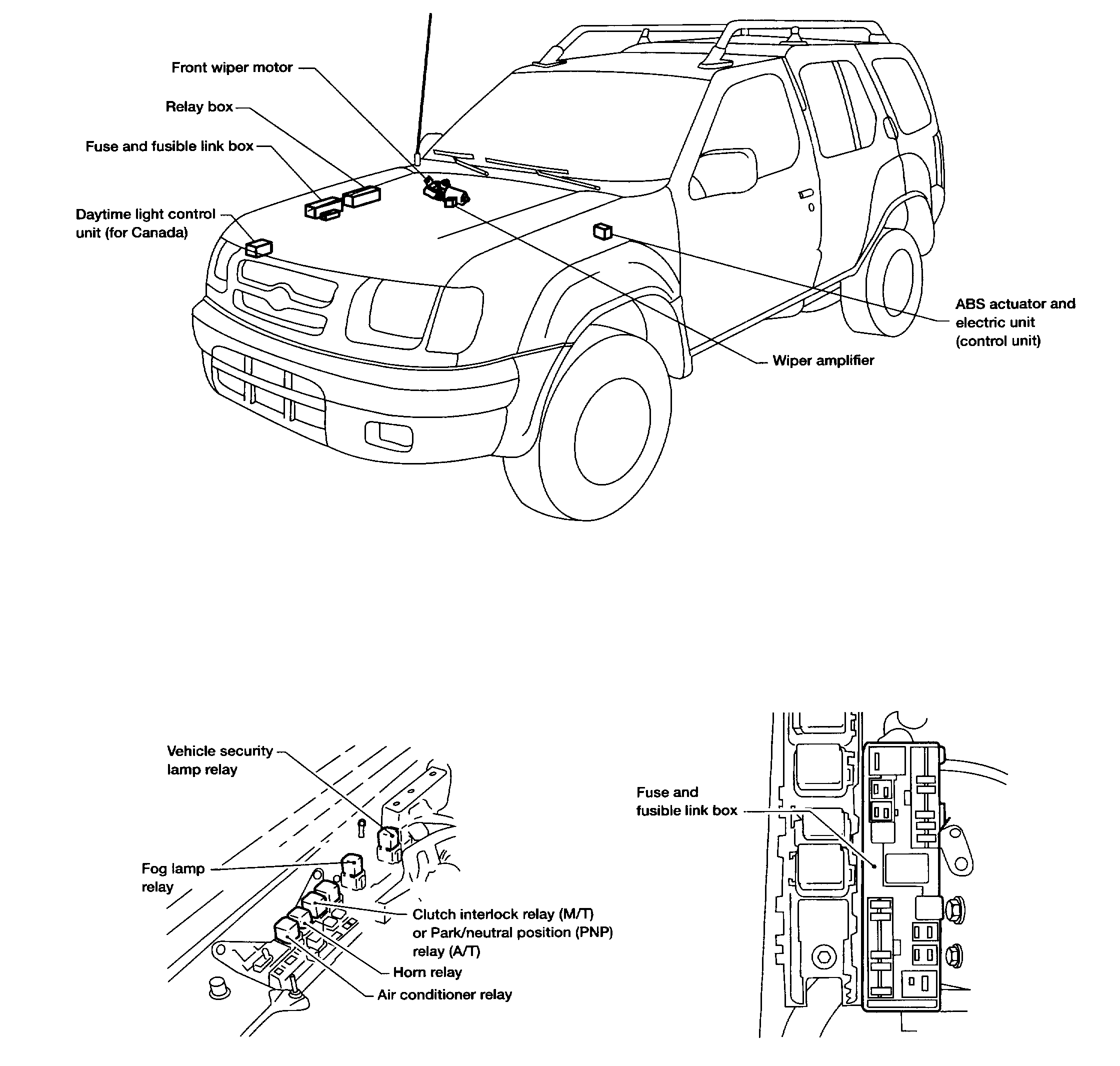

The engine starter was replaced and it still will not crank over. The only way to crank it is to apply voltage to a single wire toward the back of engine, probably sending voltage to starter.

That was a lot. Okay, after confirming that the wiring to the starter is correct and in good condition, we need to start looking at relays. Most commonly, the starter replay (or in this case, the PNP relay) goes bad. Before going directly to that, first check fuses numbers 5 and 12 in the fuse box under the dashboard on the driver's side. See picture 2 and locate Fuse Block J/B. See picture 1 to locate the aforementioned fuses.
Here is a link that discusses fuses that may be helpful.
If you find that the fuses are both good, confirm there is power to them. This link will help.
If you never used a test light in the past, here is a link that shows how that is done.
If the fuses check good and there is power to them, then we need to look at the PNP relay. If you look at picture 3, it shows where the relay box is located under the hood. At the bottom of picture 4, you will see which relay is the one you are looking for.
For this test, we can do it one of two ways. The easiest way is to simply switch the PNP relay with another one from the box that has the same part number and see if it works. If you would rather check the relay itself, here is a link which describes how it is done:
Check these things and let me know what you find. I hope this is helpful. Let me know if you need help or have other questions.
