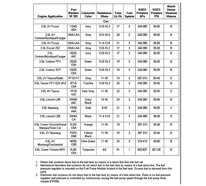

What is the normal fuel pressure supposed to be on this vehicle? My son said that he is going to get a fuel pump tester but does not know what the normal pressure is supposed to be.
Thanks
May 6, 2018 at 8:16 PM
Okay, I attached a chart for the fuel pressure.
