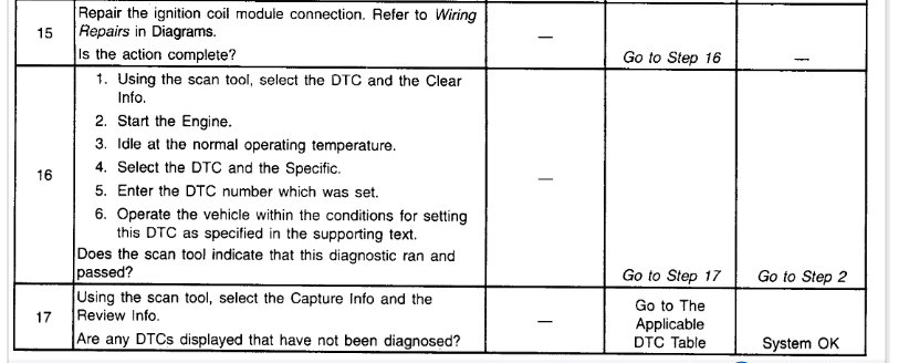

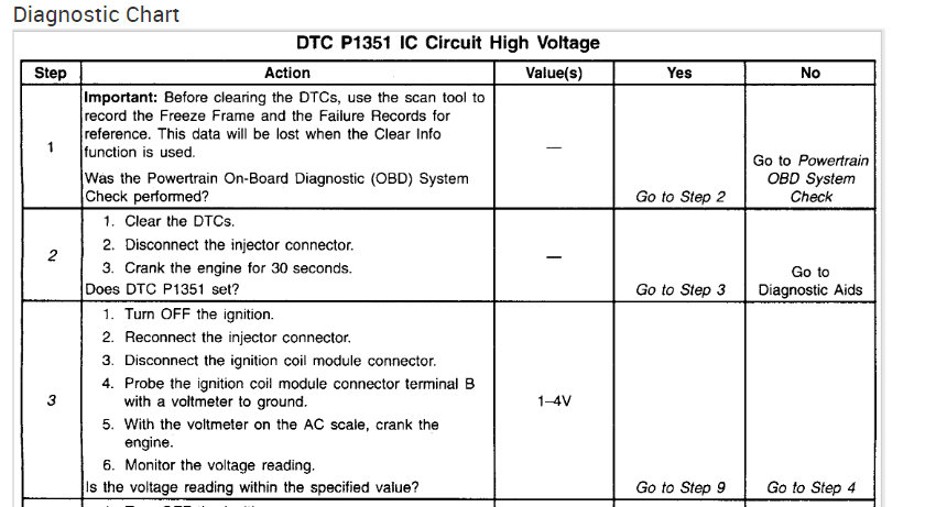

ignition control output high/pulse detected when gnd cylinder 1.
Feb 13, 2024 at 10:39 AM
  • 110,248 POSTS
In most cases, a crank no start is the result of either an ignition-related problem or fuel. You mentioned the ignition control circuit above, but I'm not sure what you are referring to. Are you getting spark to the plugs? Have you checked for fuel pressure? Are there diagnostic trouble codes stored?
Feb 13, 2024 at 10:47 AM
TOWER85
  • 16 POSTS
Getting fuel and spark, getting 2 of the same trouble code p1351.
Feb 13, 2024 at 11:28 AM

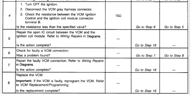

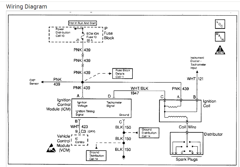

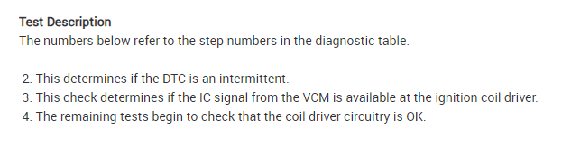

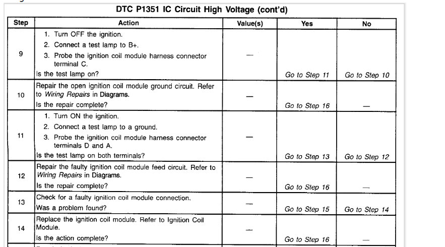

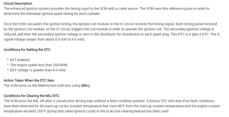

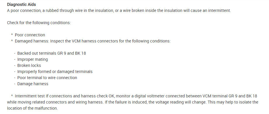

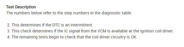

  • 110,248 POSTS
The code could be related to a couple of things. Do me a favor. I attached the diagnostics below specific to the code. Take a look through them and let me know if you are comfortable performing them.
Feb 14, 2024 at 10:51 AM
TOWER85
  • 16 POSTS
Turned out to be the fuel pump, it was charging the system but bled back into the tank.
Feb 26, 2024 at 10:36 PM
  • 110,248 POSTS
