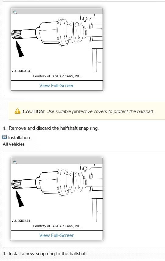

I am reading, " The inner CV joints are retained in the differential with the aid of a spring clip", but there should be no splines missing. If there are splines missing, it would seem to me that the axle would slip while turning, not pulling out because of missing splines. Can you post some photos of these missing splines?

The last and first procedure they list when removing and installing this axle is remove and install a new snap ring.

I think if the axle keeps pulling out, the problem would have to be with the differential, where the axle splines go into and where the clip is supposed to hold the axle in. It is worth a look to inspect that and see if something is wrong and the reason the clip does not hold.

Just to update you. The spring that keeps the axle in was damaged which is why the axle will not stay engaged. Being this is the case, is there any way this spring could have been damaged before repairs were made and the car would drive fine without the axle disengaging or would this be something that was caused during the new axle installation? Your input is appreciated. Thanks!

Ken, the mechanic who put my axle in has given three excuses as to why it is not his fault. After much money spent to fix and diagnose why axle is falling out I found out the axle replacement is suppose to be a half shaft only. Mechanic removed entire shaft. Jaguar said the shaft part in transfer case is not to be removed because the risk of damage. Now mechanic who did the work is saying the person who put in the axle he took out damaged it. This makes no sense since if this was true, the car would not be able to drive since the axle cannot stay engaged. Also, if he believed this he should not have done the repair. First time it was the part and second time it was the original axle was installed wrong and now it is the axle he replaced was put in and that person damaged the spines and spring. Splines and spring is causing axle to slip so this does not seem possible it was already damaged as car drove fine and just heard clunking noise when driving. Front right axle replaced and still heard clunk noises. Now ball bearings seem to have been the real issue.
