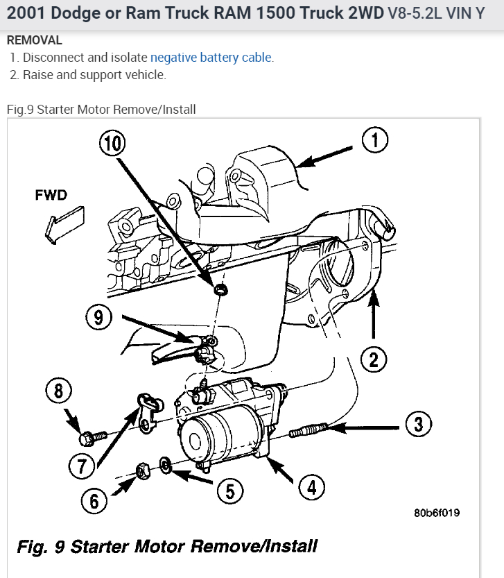

Will a starter from a V6 go on a 318 in a Dodge Ram 2001 series?
Aug 31, 2023 at 12:03 PM
  • 54,837 POSTS

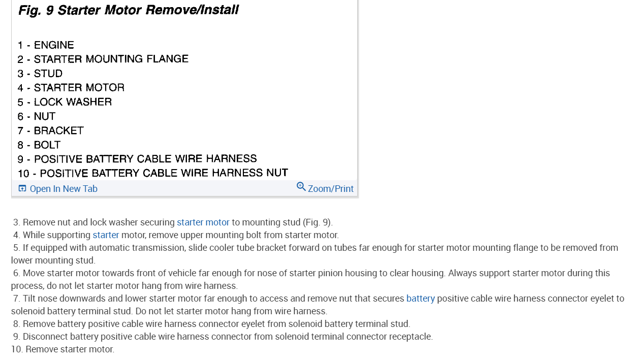

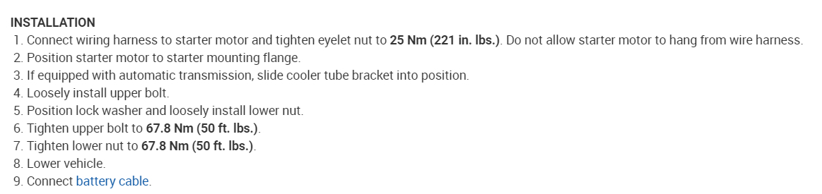

They have the same part numbers so I will so yes.
V6 - Starter 56027702AC $205.00
V8 Starter 56027702AC $205.00
Here is a generic guide to help you step by step with instructions in the diagrams below to show you how to use your car:
Check out the images (below). Please let us know if you need anything else to get the problem fixed.
