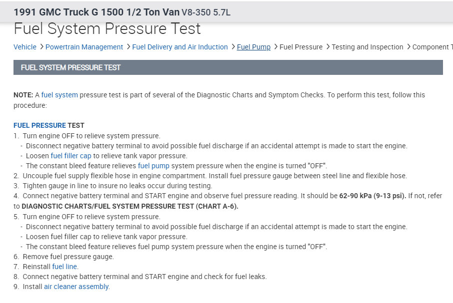

Also, here is a link that explains how to test fuel pressure. On this vehicle, you will need to place a T in the fuel supply hose under the hood and then attach a pressure gauge to that T.
I attached the directions below specific to this vehicle. They include the manufacturer's fuel pressure specifications.
See pic below.
