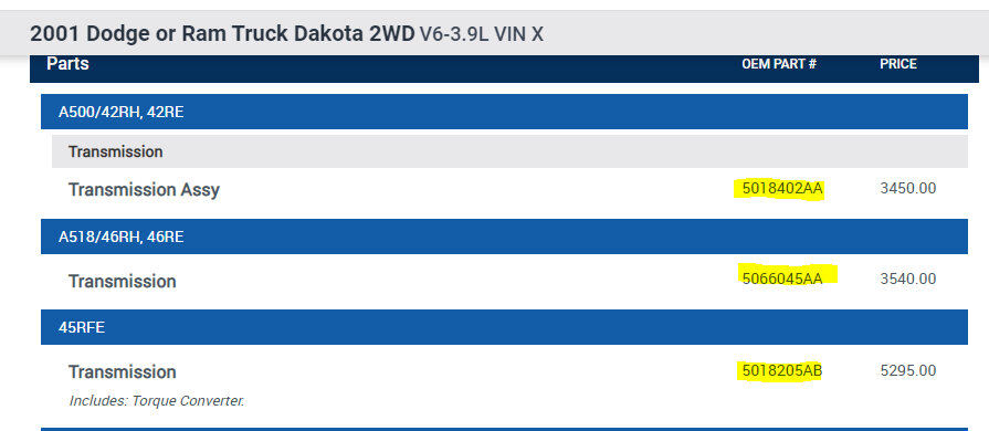

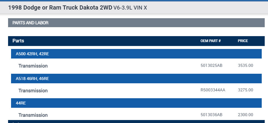

Yes, I have the vehicle listed above and I need a transmission for it, will a 2001 Dodge Dakota fit?
Jan 18, 2023 at 3:08 AM
  • 110,248 POSTS
In each model year, there were three different possible transmissions used. Although the transmission model is the same, the part numbers are different. That indicated a change.
I wish I could tell you it would work without issue, but I feel you will run into trouble with sensors, solenoids, or something electronic. The basic case will be the same.
I attached two pics below so you can see what I'm referring to.
