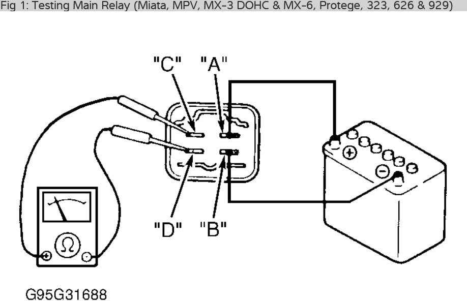

HMAC300
  • 48,601 POSTS

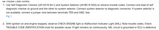

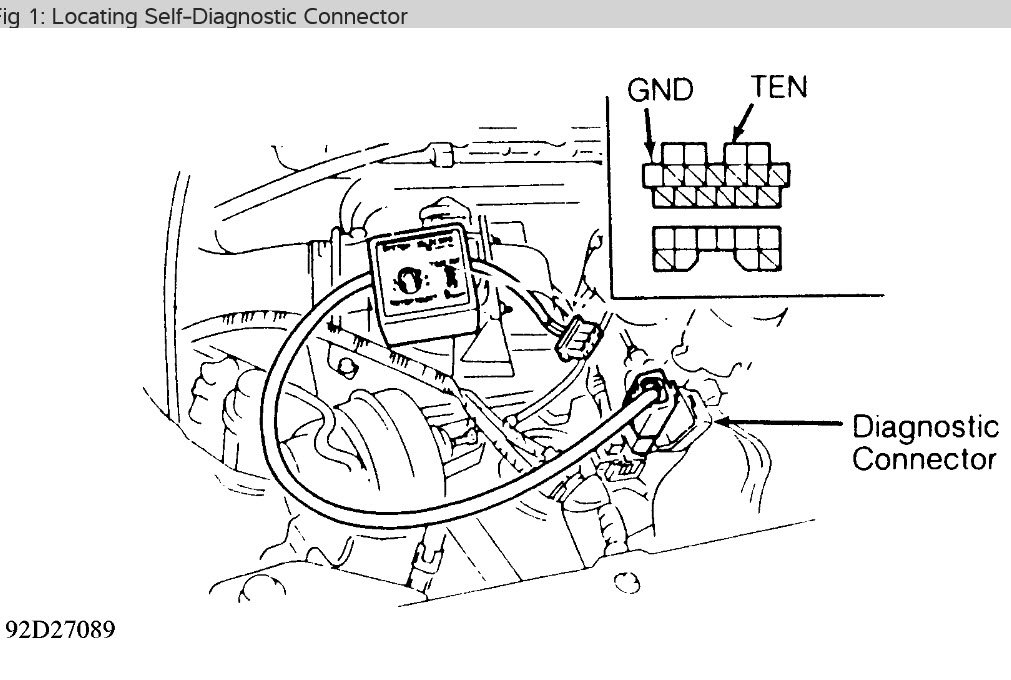

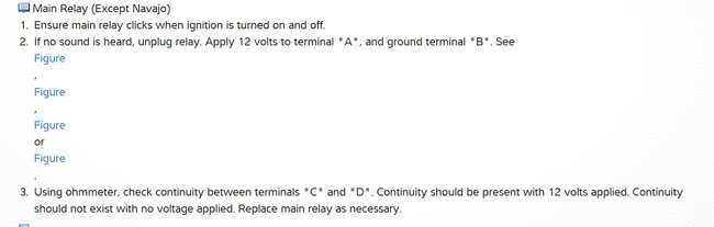

check main relay and fuel pressure check inertia switch under front floor mat pass side. then scan for codes. See pictures.
May 10, 2017 at 10:34 PM
