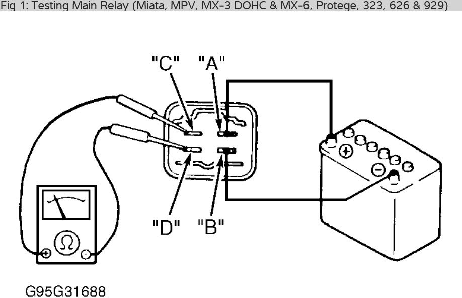

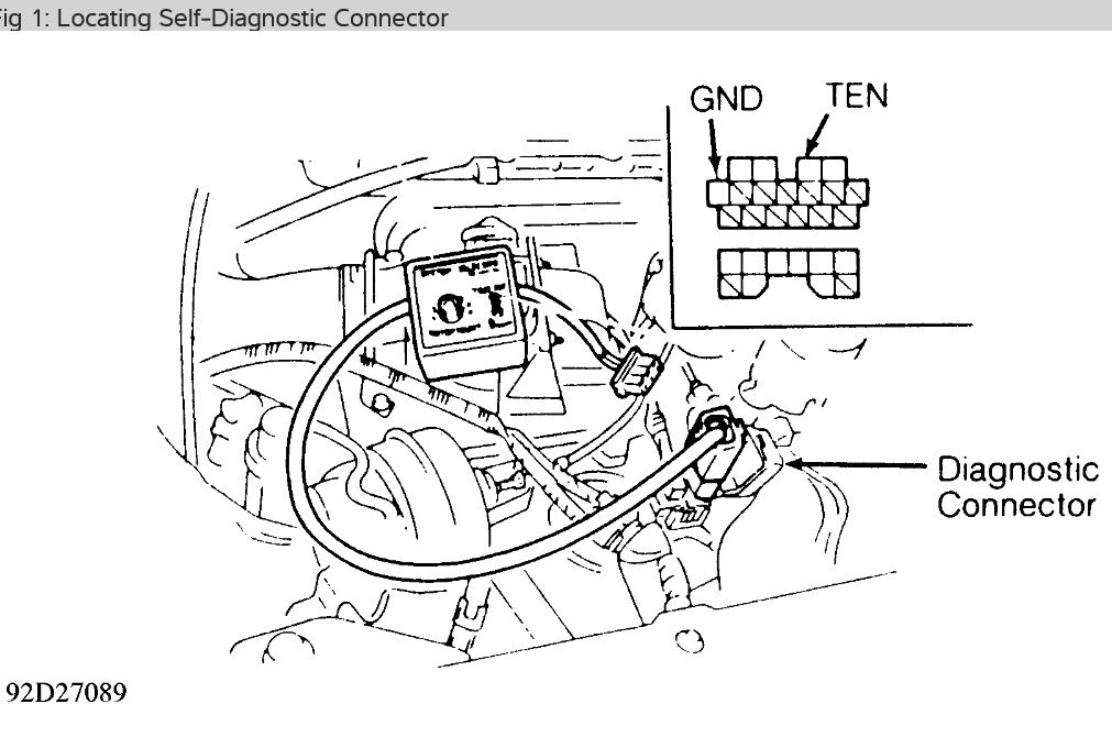

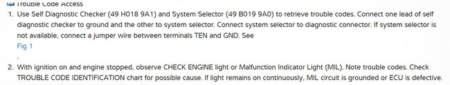

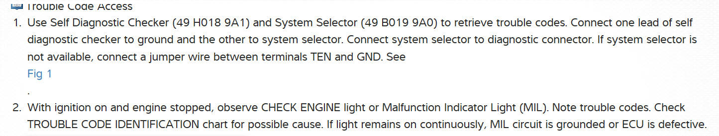

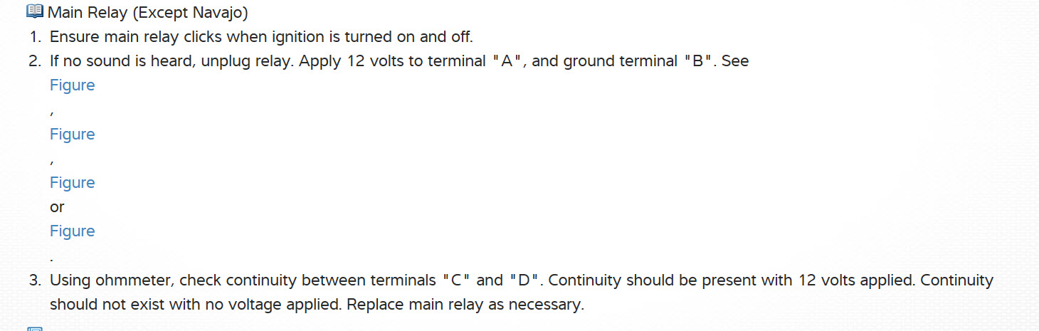

check main relay and fuel pressure check inertia switch under front floor mat pass side. then scan for codes. See pictures.
