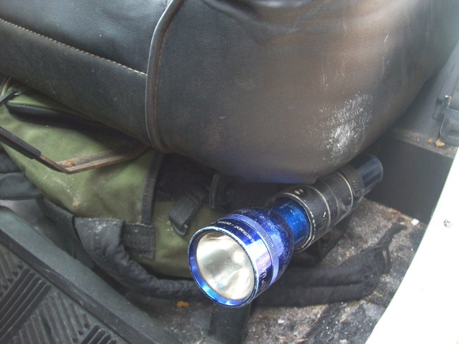

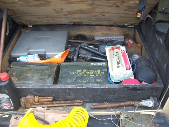

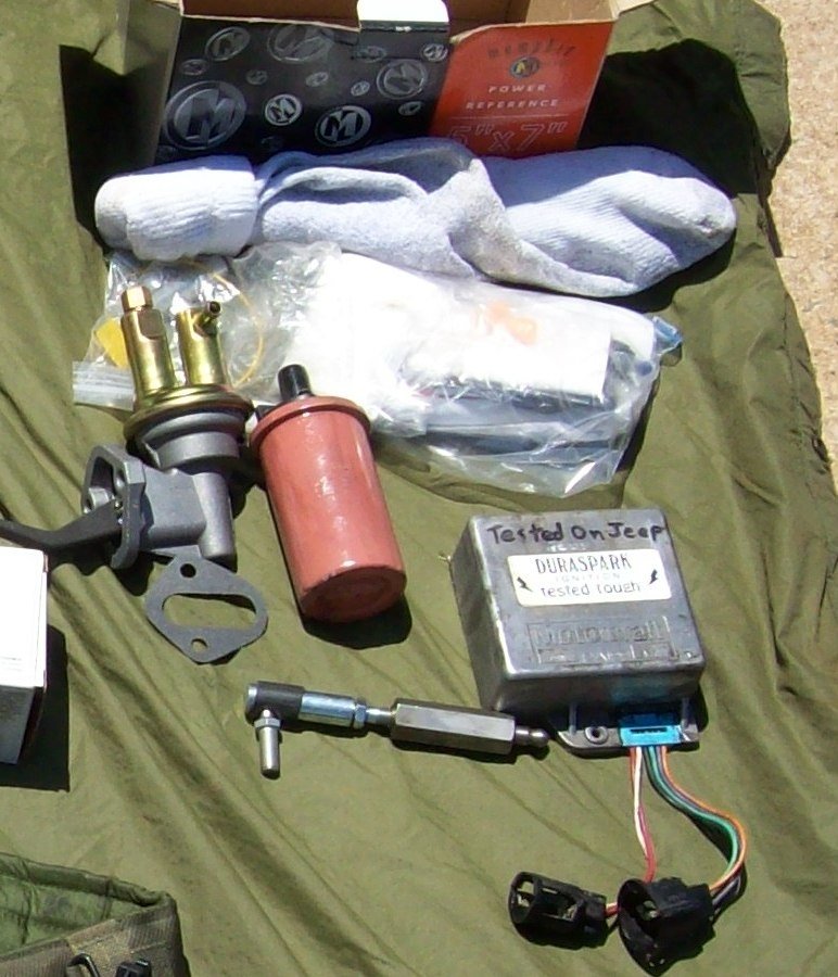

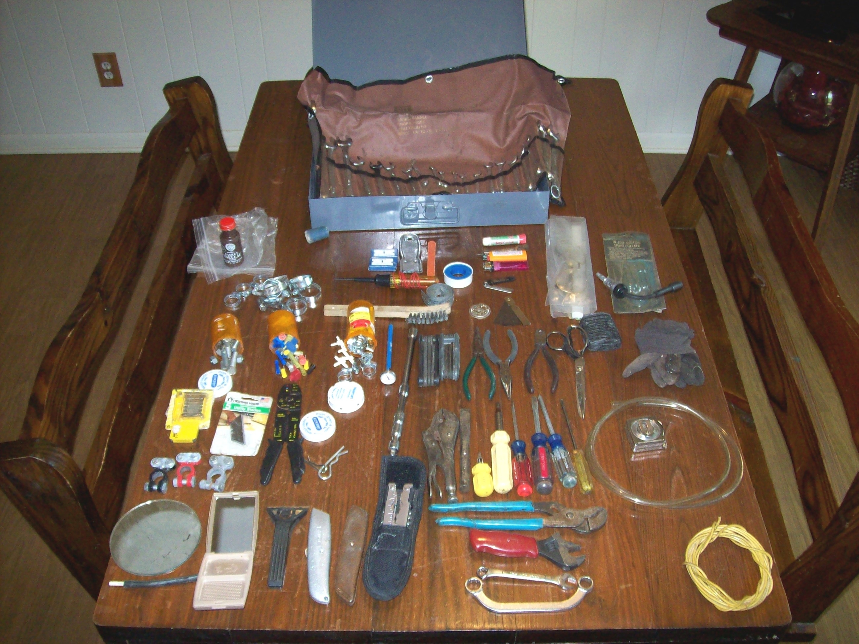

With mine, things can and do happen sometimes, 99% of the time I can handle them on the roadside (sometimes even able to aid another unprepared CJ feller). I keep wrenches, sockets, screwdrivers, and other repair items on board. I also have a spare coil, mechanical fuel pump, and ignition module and more!
Things I did in the beginning when I tried to stay off of a tow trucks hook was to keep at least a gallon of drinking water which double dutied to be used in the radiator if needed.
A couple of quarts of oil and some brake fluid.

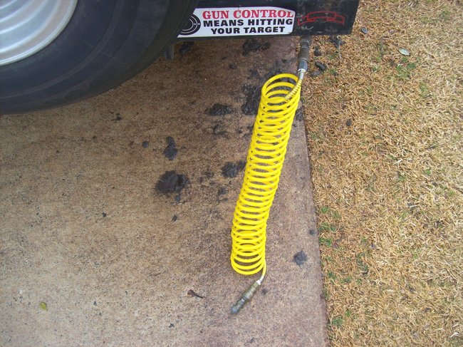

Some tire plugs and one or two of those really cheap (but effective) tiny cigarette lighter air compressors. I found that the compressors need to cool after a period of time or they will melt down and be useless (see their directions, don't push their limits!). My CJ-5 now has a train horn and an on-board air compressor to run it and accessories.

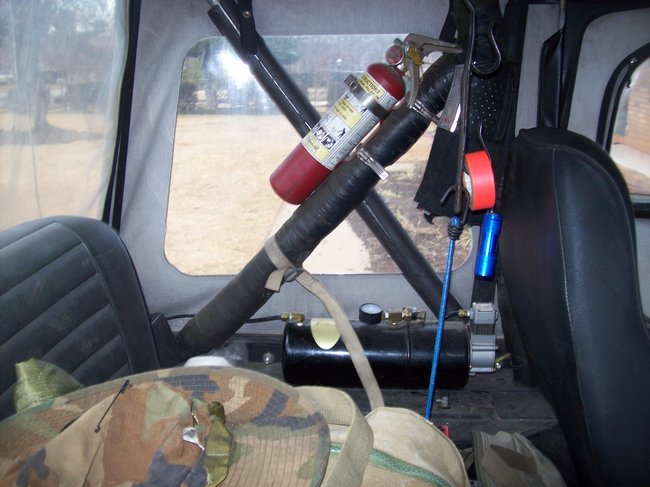

Keep a 5 lbs fire extinguisher with you, anything less is a fire teaser.
