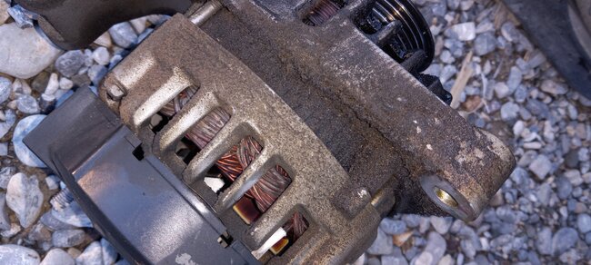

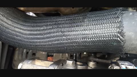

I think this sound is coming from the alternator. It's a high pitch whine. This video is 5 mins after running.

That is a good one, I would disconnect the battery to see if the noise stops, and if so replace the alternator, thanks for the video it helps. Let us know how it goes, Ken

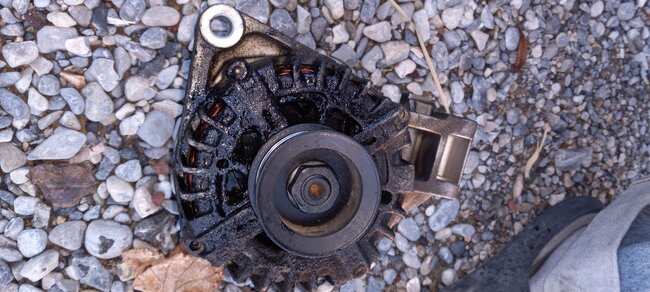

New alternator is on and working! No more whine. The dummy lights are still on, is it possible the bad alternator shorted something? Probably another issue all together.
Here's pic of the oil covered melted wire alternator. Wonder why it messed up lol.

lol, yep that is a bad one there. Nice work getting the problem fixed, please start a new thread for the warning lights, Thanks for the images :)
