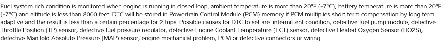

your fuel pressure is to high for the 172 code check with a gauge key on only. see pic and link.
