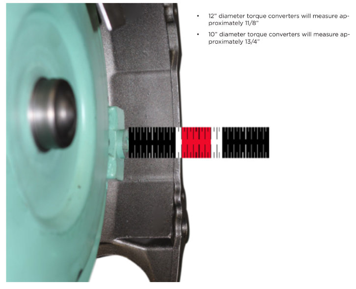

Put in a reman trans 4l60e. It won't shift out of first it doesn't indicate the gear position. Several codes and several service warnings. What do I need to look at?

A big problem could be the installation of the torque converter. If not installed properly this will break the oil pump drive which in turn will cause not drive.
One of the most common issues with the 4L60E is a broken pump rotor due to improper torque converter installation. The following procedure should be followed to completely and correctly install the torque converter.
If the torque converter has been removed:
1. Spin the torque converter and push in towards the transmission.
2. Listen and feel for three distinct “clicks” as the torque converter engages each component (input shaft, stator support and pump rotor).
After torque converter installation or if the torque converter has not been removed:
Measure the distance between the torque converter mounting pad and bell housing face to verify torque converter is fully installed.
See image below for installed depth of torque converter.
