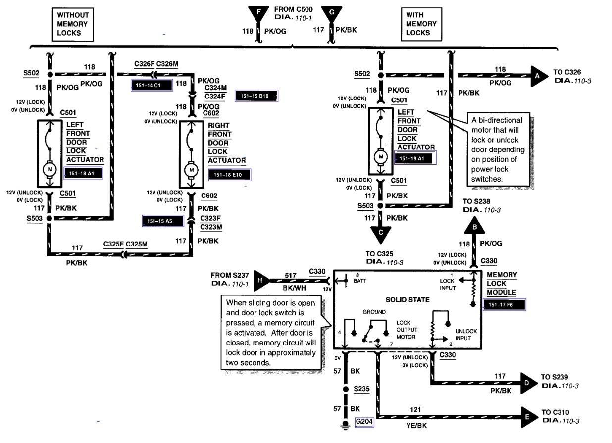

Why won't my electric locks work?

Hello everyone, its just me Warren, ok here is what is happening now / this time. I was about to lock my doors with the key fob and the remote start i have on there operates like normal. the van starts, the alarm works and when you go to lock the doors with the key fob the alarm chirps, flashes the lights etc. But i don't hear any loud sounds coming from the door locks like i normal would hear. But if you sit in the van and hit the button or key fob you hear it trying to lock but it doesn't. Any idea what it could be? the batteries in the key fob is low i tested that a while ago (that could be the answer but i don't see how). And i check both fuses under the dash and both fuses are good. Lastly, i like how you did with the website it looks really good.. :-D

OK, so if you use the fob remotely OR you use the button on the door things seem to work, but the doors don't actually lock. Is it all of the doors that don't lock? If you push the lock manually will they lock or are they very stiff and don't move very well? When you try the locks do the lights dim or change? If it's all the locks then it could be a bad relay. Is this a factory system? Just trying to narrow down the problem first.

OK, blowing a fuse when actuated sounds like a broken power wire that has shorted to ground instead, that could also be in the flex area. The wires are color coded The ground wires are Black, the power wire in this case is Black with a white stripe. The kick panel should be snapped in. Just be careful, 26 year old plastic will be brittle.

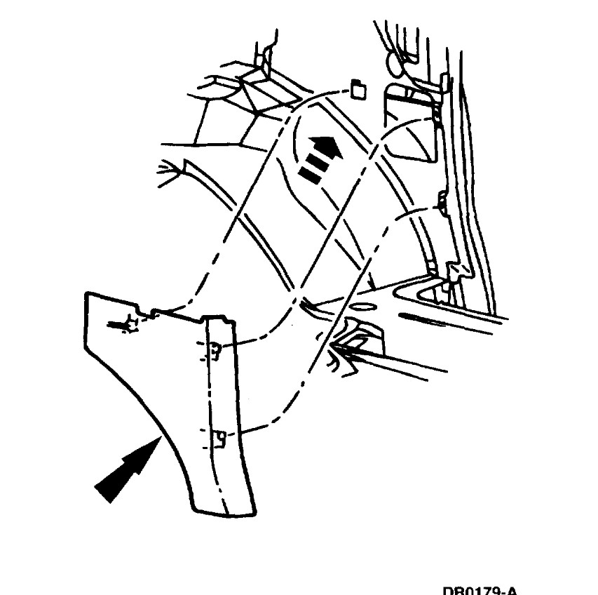

Ok i will start there... looks like this kick panel on the driver's side has never been taken off. Its in there sold too. The one on the passenger side was easy to take off etc. Ok when i get this kick panel taking off what is it that i am looking for reason i am asking again is because while trying to take it off. we managed to get that little clip that comes off allowing you to get the pull hood thing through. And it looks as though someone shoved ALOT of wires in there. I was told earlier that, this is where the so called keyless entry module was located. Because i sure didn't see it under the dash unless its a object i am not used to looking at. At that may be the case too. Also someone told me that the driver's side door was the master switch to all of the door locks. If that one fails it will stop the others from working. Now if that is true i have no idea.. I shared that with you to see if that was true or not.

Yes the drivers door is a master switch however you stated that moving the switch one way would blow the fuse, that should mean the switch isn't the issue. As far as what to look for, there should be a few wires in a ring terminal bolted to the body, one of those should be the Black ground wire, that wire goes across the dash and into the right front door and connects to the right hand switch, you want that one and one that is Black with a white stripe, that should be the power wire that goes into the door flex and into the left door switch. Then if you remove the door panel you can get to the other end of the wiring. The way the system is wired is a mess. While the drivers door is the master switch it is also the last in line to the actuators. It's a mess but a bad wire shouldn't be that hard to find a bad wire. Because it blows fuses the issue almost has to be between the drivers switch and the actuators.

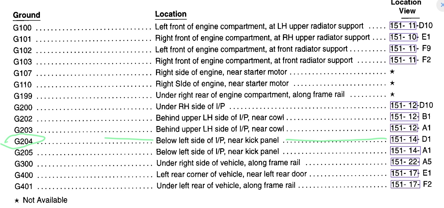

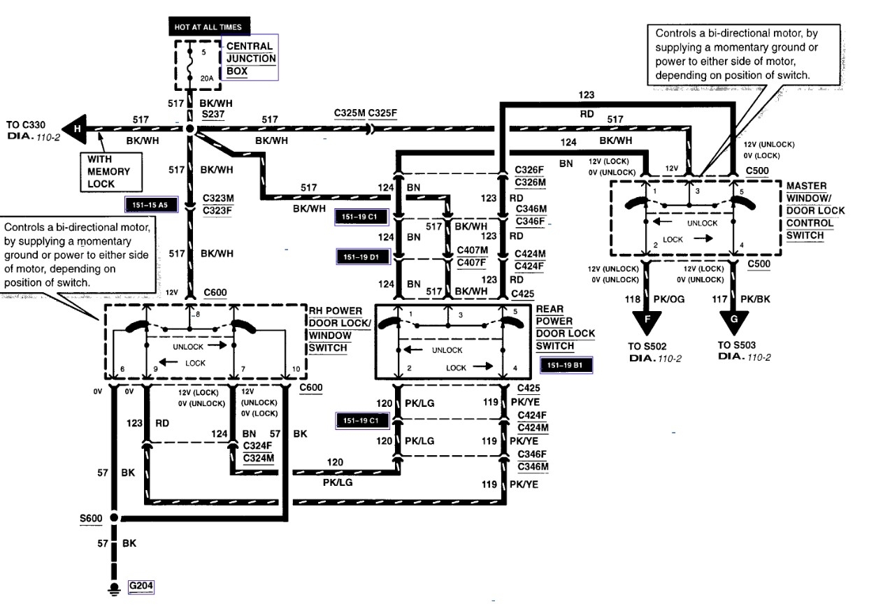

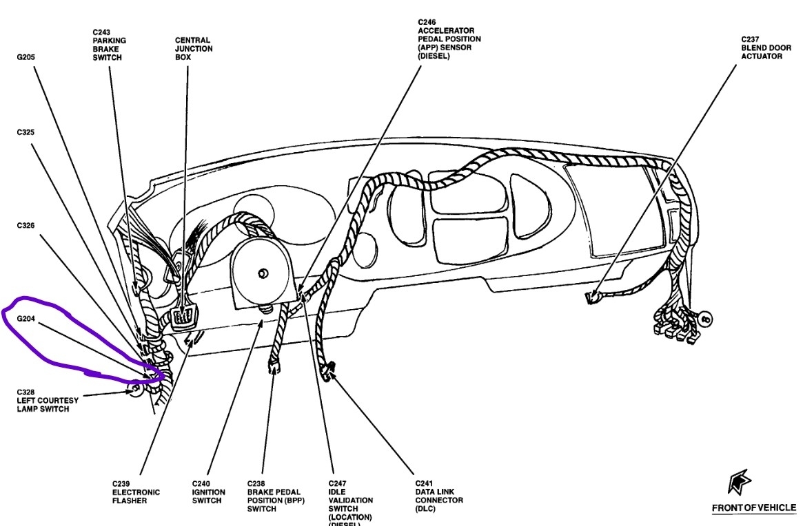

The ground is in the front of the door behind the kick panel. Attached is the location chart. The connector for the locks is in the same area. The kick panel can be a bear. The attached is the right hand panel, the left side should have the same clips just reversed.
May 3, 2026 at 11:06 PM

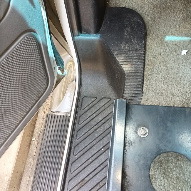

You guys always seem to get a hold of the neatness documents lol Good i am glad i was looking for in the right place the first time you told me.. So, to get the panel off do you lift up more and toward the driver's seat? Or just pull it back directly toward the driver's seat? And you are right it is a bear getting this one off. I am afraid of just man handling it because i don't want to break anything.
May 4, 2026 at 1:55 PM
STEVE W.
  • 15,409 POSTS

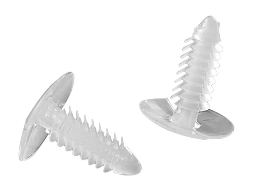

They were made to be installed, clip in and never be removed. Then after 26 years the plastic gets really brittle and it can shrink some as well. I can say I've broken a lot of plastic over the years. I'm a pro at plastic welding and repair! In this case I believe they are simple push trees in slots on the back of the panel but it's been a while since I had to remove one. They are a bear to remove once installed.

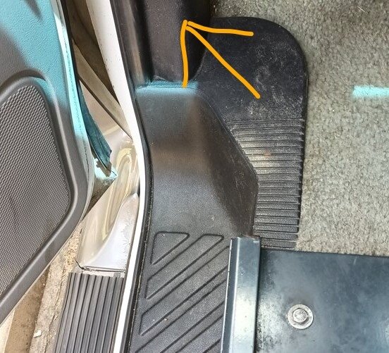

That piece shouldn't need to come off to get the piece above it off, see photo. The power feed goes through each door but the dome lamp switch is a different circuit entirely. Fuse 8 would shut down the engine, not the locks. Testing fuses is a lot easier with a test light, a fuse can actually look just fine but still be bad.
https://www.2carpros.com/articles/how-to-use-a-test-light-circuit-tester/
Using that method on both sides of the fuse tells you if it's good quick.
May 15, 2026 at 8:10 AM

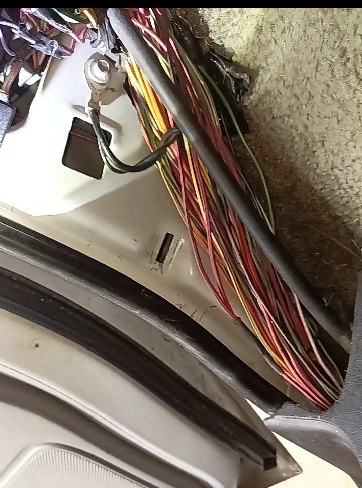

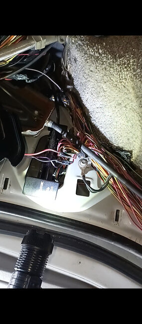

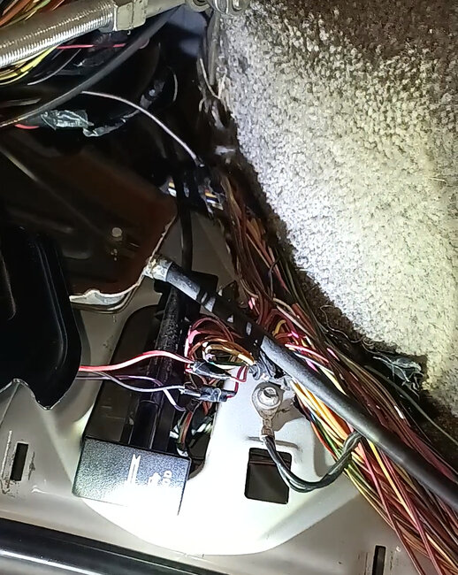

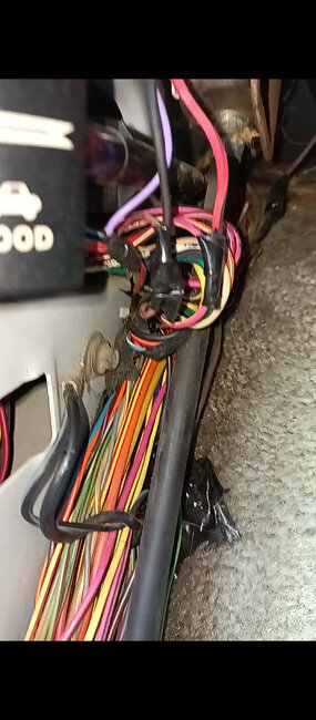

Well i got a change to mess with it today and i got the kick panel finally off. I seen alot of spliced / taped wiring behind the kick panel. The ground wire that was bolted to the van was the only thing i seen behind the kick panel that looked like it was sold, I moved a few wires to take a look around behind there and i didn't see anything.. But then again i don't have a trained eye so i guess i didn't know what i was looking for. And while i was doing that.. i must have moved something to much is because now the cargo lights don't come on anymore. The locks are still the same (not working) the remote start and alarm part still works.. Now i am more frustrated then ever. I didn't get to use the test light where i needed to.. being in a wheelchair creates problems.. but i did get to use it once on a fuse behind the driver's door and come to find out that fuse was the cigarette ports for charging your phone and things with,,, That part works only when the van is started lol. And the keyless entry module that is in the side panel behind the drivers door has to be the one from ford. It looks nothing like the one that goes to my remote start / alarm system. Make matter worse is that module.. is bolted to the wall some kind of way and there isn't much room to lose the screw or bolt out to get a real look at it. I even wiggled the wire part between the door and the body of the door and the locks didn't work but you still can hear that clicking sound in the side panel behind the driver's seat.
May 15, 2026 at 2:57 PM
WARREN1814
  • 220 POSTS
And i did not see the keyless module that works my remote start and alarm system at all. If its on that van it must be under the hood some where because i didn't see it at all. Unless the installer straight wired it some kind of way. If that is possible.. I will look again later on but so far i did not see it at all. :-(
May 15, 2026 at 5:31 PM
WARREN1814
  • 220 POSTS

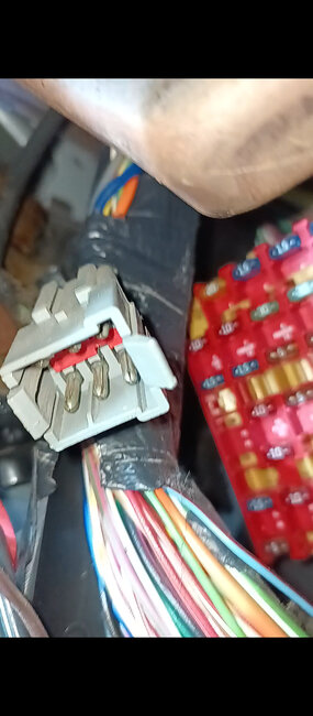

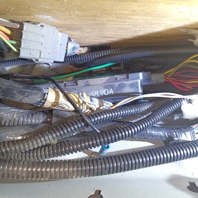

Here are a few picture i got to take... not very good but that's the best i could do my cellphone doesn't take good pictures
May 15, 2026 at 6:18 PM
WARREN1814
  • 220 POSTS
2 more pictures
May 15, 2026 at 6:20 PM
WARREN1814
  • 220 POSTS
Last picture right here... sorry for so many post...
May 15, 2026 at 6:28 PM
STEVE W.
  • 15,409 POSTS

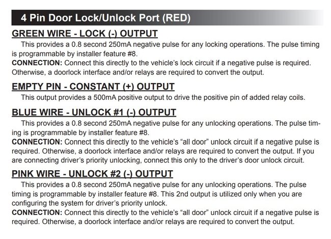

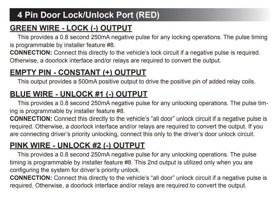

No problem on the extra posts. I'm going to bet at least one of your problems in in there under one of those bits of tape. Don't get too upset. I've seen much worse work by "professionals" before. One of the worst was literally wires stripped and just twisted together, no tape, nothing, and that was on an Ambulance !!! Rewired it all for free, they suddenly had things working that hadn't since they bought the thing. Anyway, if you can get to them, I would pull the "connections" open one at a time and look for loose or damaged wires. Open one, write down what colors are in it and if it looks OK. Take a picture if you want as well. Then go here and get the manual. I suspect the lighting is messed up because of this as well. A lot of alarms flash lights and turn on interior lights, so if they cut and spliced the wires, they may have just fallen apart.
https://www.caralarm.com/Content/Manuals/AL-XX70-B%20install%20guide%20V1-3_1870_English.pdf
With that you can see the table of which wires do what. The lock wires all come from the red connector on the aftermarket unit. Hit the button a few times and see if you can find where they hid it, tucked under the dash or behind trim panels are popular places, so is under the seat. If yours has the antenna out where you can see it, look around that area under the dash or wherever, it won't be far from it. However my suspicion is that it's in that rats nest, probably cut a wire and then spliced the two cut ends with something from the alarm, it has come apart and caused your problems.
May 15, 2026 at 7:04 PM

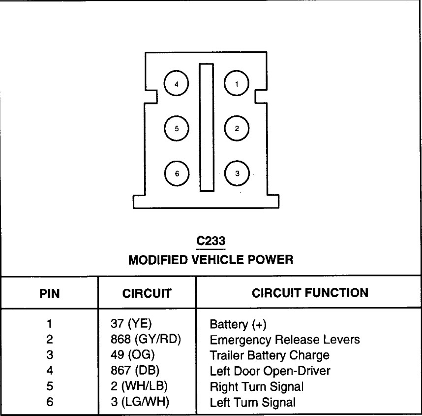

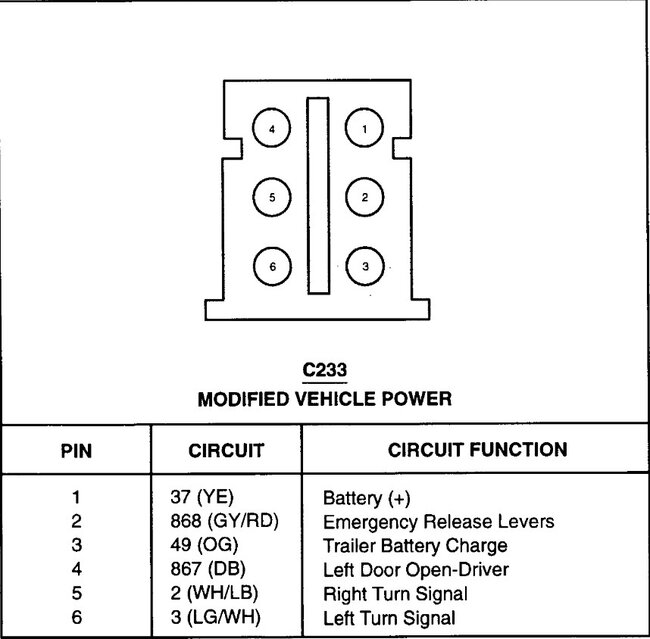

Might be an option you don't have, lot's of those on vehicles. Might be the attached one. Looks to be in the correct spot. Called "Modified Vehicle Power". Used on emergency type vehicles to handle specific things they need without needing to tap the wiring in other places.
May 16, 2026 at 3:32 PM
WARREN1814
  • 220 POSTS
I was wondering what that was for... i suppose you just can't plug anything you want into that plug can you? Don't worry i haven't try to.

It would depend on what you wanted to do. Where I generally see it used is to plug in lighting control modules for things like ambulances or police related vehicles. Never really bothered with it myself.

I've done that a number of times when the system was causing more grief than it was worth. Especially if it was one that there was no paperwork on. In this case the company still has install and diagnostics for the modules. They might help but I would do some testing. The way it's blowing fuses though isn't likely to be the unit itself. It doesn't trigger it just sends a signal through the original wiring and that triggers the locks. I suspect the remote locking system is fine, but there is a problem on the original vehicle side. Either the BCM or a bad lock that is shorting out. That gives a high draw and the current burns out the fuse. I think you could remove the remote and using the factory locks would still blow the fuse.
I never take service info as gospel, but it's very possible that the upfitter that built the van added to a circuit or altered things. The problem then becomes finding that build info. Or we do it the hard way, by going to the alarm module and disconnecting wires and then creating a signal to trigger the different items and trip the breaker or blow the fuse. Then go to the vehicle control module and trigger things there and see what the issue is. The attached are the diagrams for the remote unit.

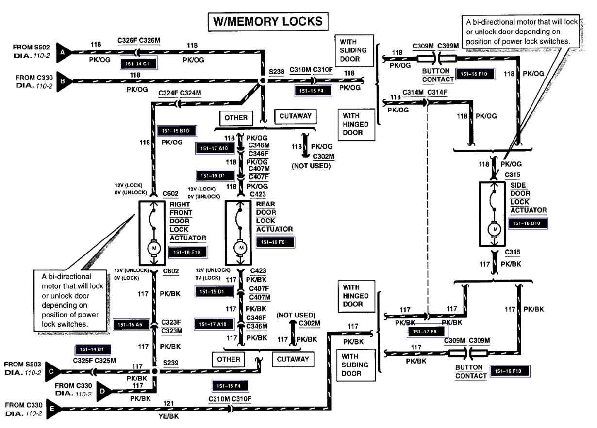

Well first of all let me say thank you for sending me the diagram of how that is wired up. and i hope like crazy its not the BCM. Because we all know it has been discontinued by Ford. The sad thing for me is going to be getting to it and removing any of it. I read where a company can rebuild our BCM's too.. I am sure you guys read / seen companies too. Now back to the diagrams you posted. If i where to unplug C do you think that would be enough so my BCM might start working again providing it didn't go belly up on me and providing the installer didn't cut the crap out of my wires down there? When i took it back to the installer of the remote start / alarm system one guy as i said something kept popping the fuse.. and then the boss guy came out and said it was my BCM. I was only interested in the remote start part of the system anyway. Had i known it was going to do this that's just what i would have had install instead of the alarm system part as well. Also, today i tested the original key fob again and press the panic button and only the horn sounded this time. no flashing lights of any kind happened. went by each door and heard nothing. Using the remote start system's remote. I got the horn to blow, the head lights to flash and the tail lights to flash But no dome lights or locks on none of the doors. Do you think calling tech support would help out any? Because the last time i tried it, they just gave me the number to the local installer where i had it installed at lol Hey if buying a new system( Remote start only) will help i might consider doing that as well.
Oct 27, 2026 at 8:17 PM
