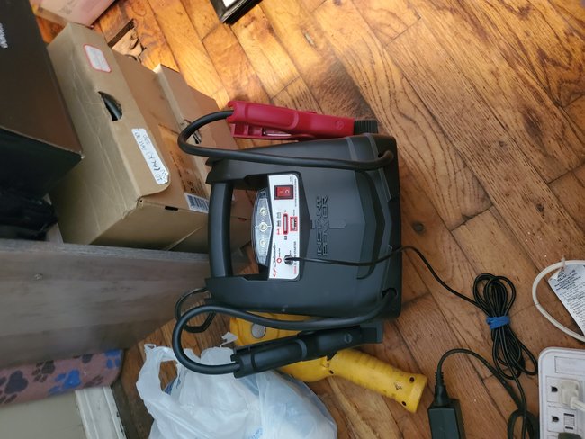

I bought this portable jump box and charged it all the way up to jump my car off, but when i hook it up to my battery and turn it on it will make a little clicking sound and if i open my door the lights will come on for a second then it goes off. when i take the jump box off it's still completely drained. Is this because my battery is too drained to jump off or I need a new battery?

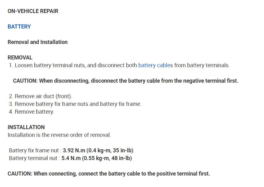

It is either the connections to the jumper pack or the car battery is internally shorted. Most like it needs a new battery and the charging system tested.
https://www.2carpros.com/articles/how-to-replace-a-car-battery
