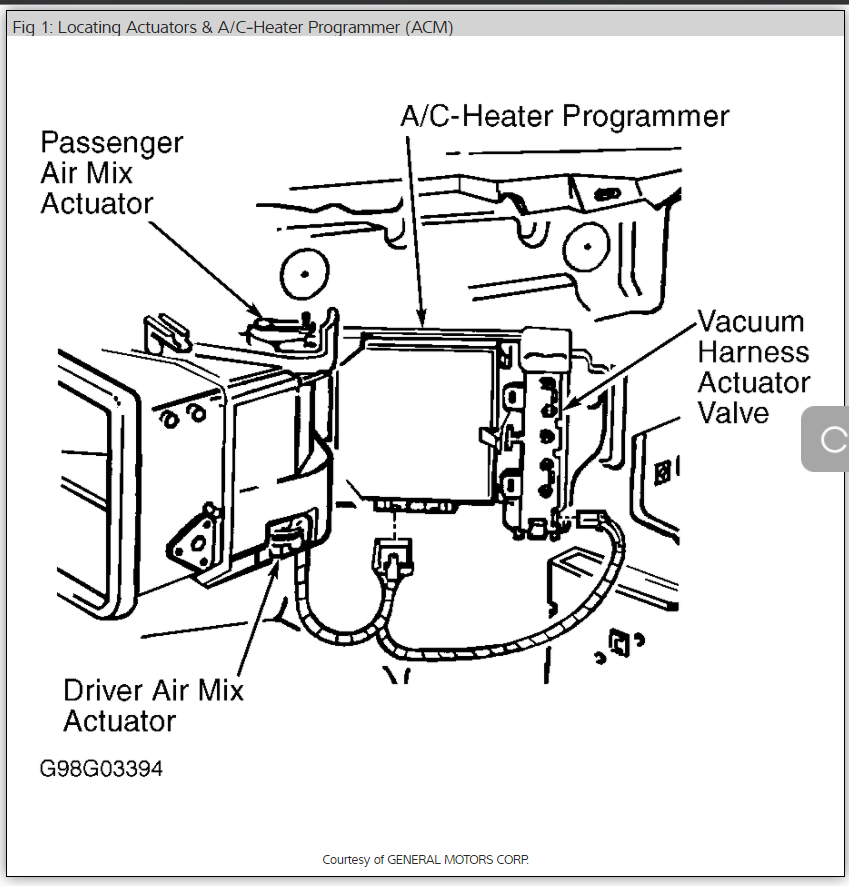

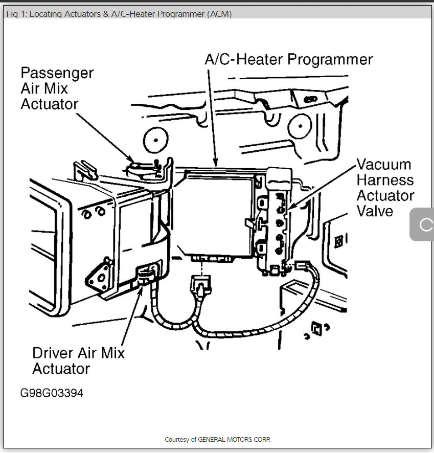

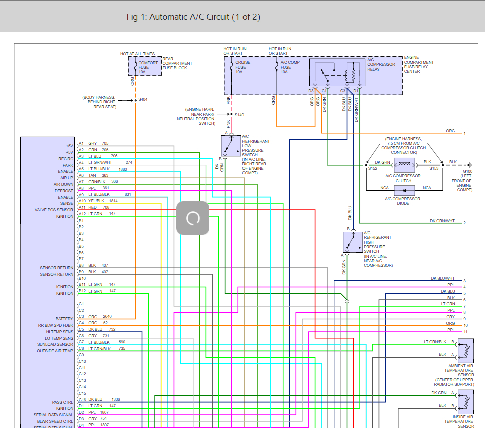

Why when using air conditioning does air swap from blowing out the front dash vents back and forth to the defroster vents?
Aug 31, 2017 at 7:37 PM
  • 55,423 POSTS

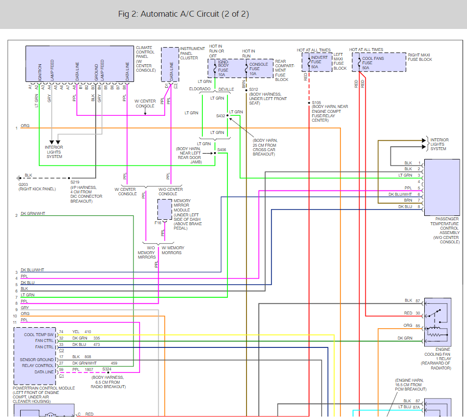

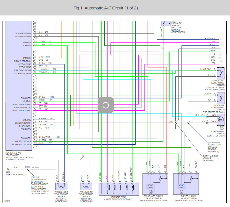

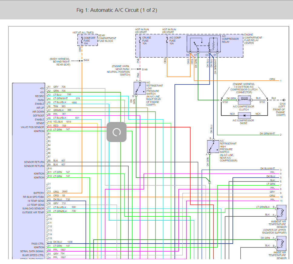

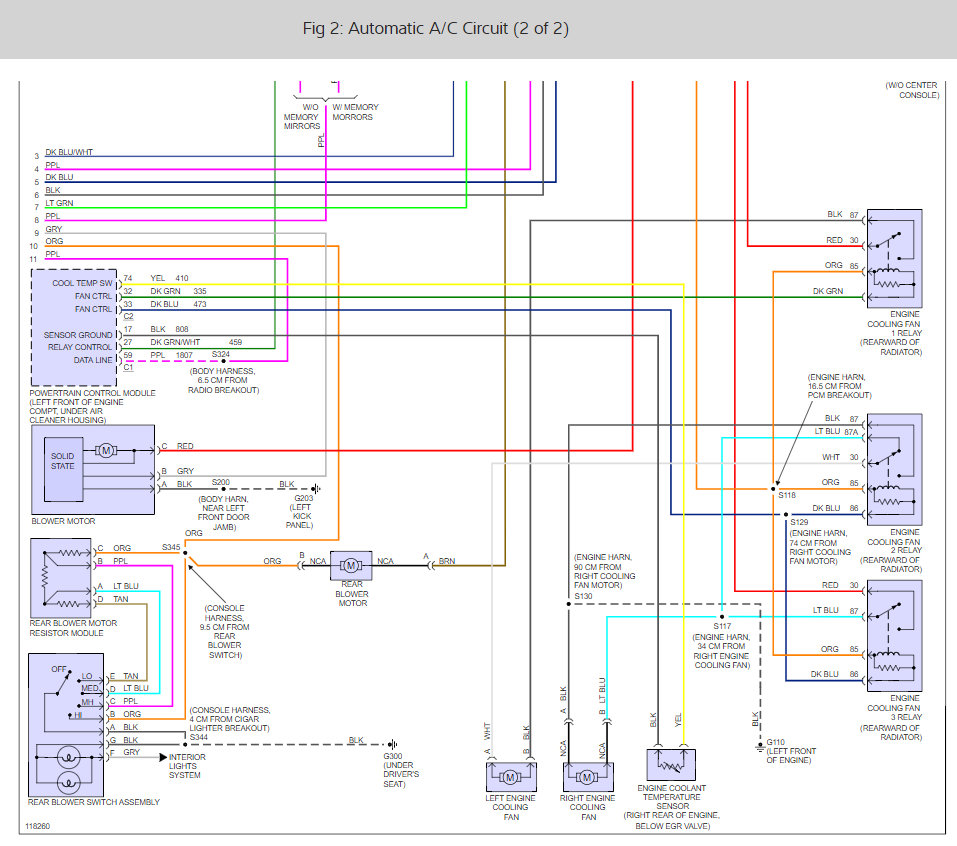

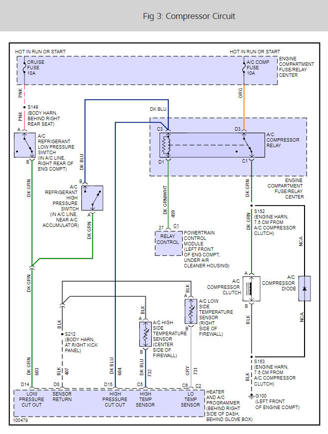

It sounds like the ac conditioner programmer has gone out and it needs to be replaced. Here is the air conditioner wiring diagrams so you can do some testing along with the programmer location so you can confirm the problem and the fix.
Confirm that it is getting a good ground, then replace the programmer, try to find a used one.
