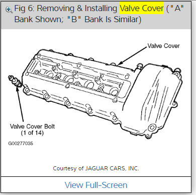

There is a very bad smell when accelerating coming inside. Smells like exhaust emissions in combination with burned oil.

It sounds like you have valve cover gaskets that are leaking. Do you see smoke from under the hood? Also, do you have any exhaust leaks?
Please let us know.

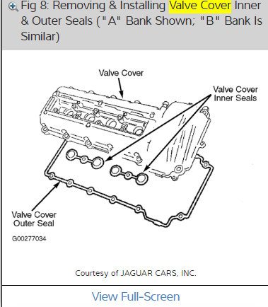

Thanks for the quick reply and the information sent. Yes, I see oil on top of gasket. I will order the gasket kit and replace it.
Jul 15, 2018 at 5:46 AM
Experienced Mechanic
55,746 POSTS

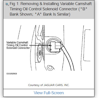

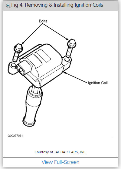

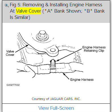

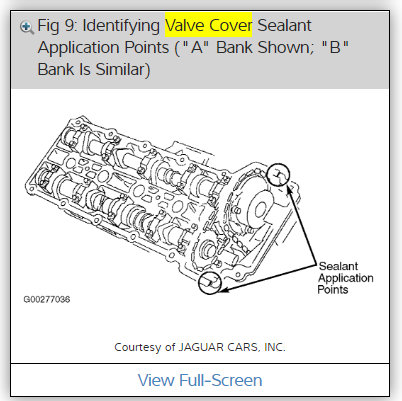

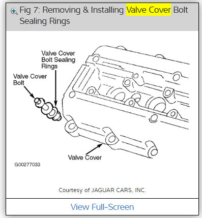

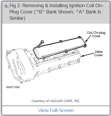

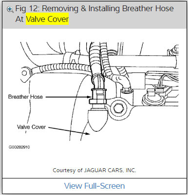

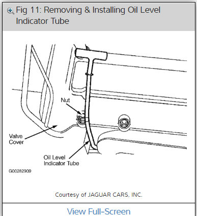

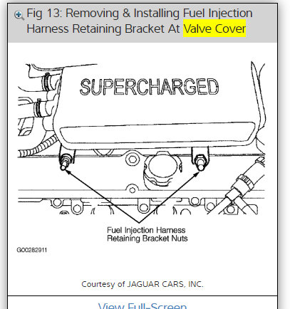

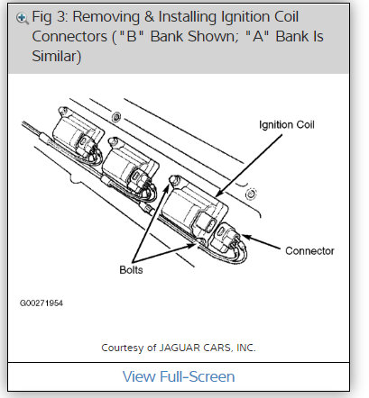

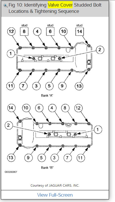

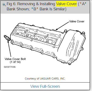

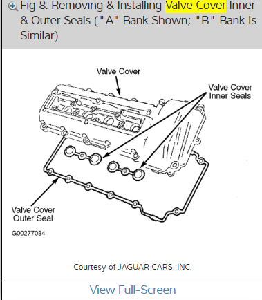

Good work. Here is a guide and diagrams below to help you do the job:
https://www.2carpros.com/articles/replace-valve-cover-gasket
You can get the gasket from Amazon or Rock Auto.
Images (Click to enlarge)
