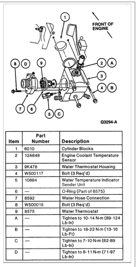

temperature gauge no work. changed temperature sensor by thermostat. does not overheat. heater still works the same?

It sounds like you have a thermostat that is stuck open which will cause the heater and the temperature gauge not to work as well.
Here is a guide to help you see what you are in for when doing the job:
Here is how it will be on your car (below).
Image (Click to enlarge)

thank you. i will work on this Tuesday, December 26. Christmas is here.
