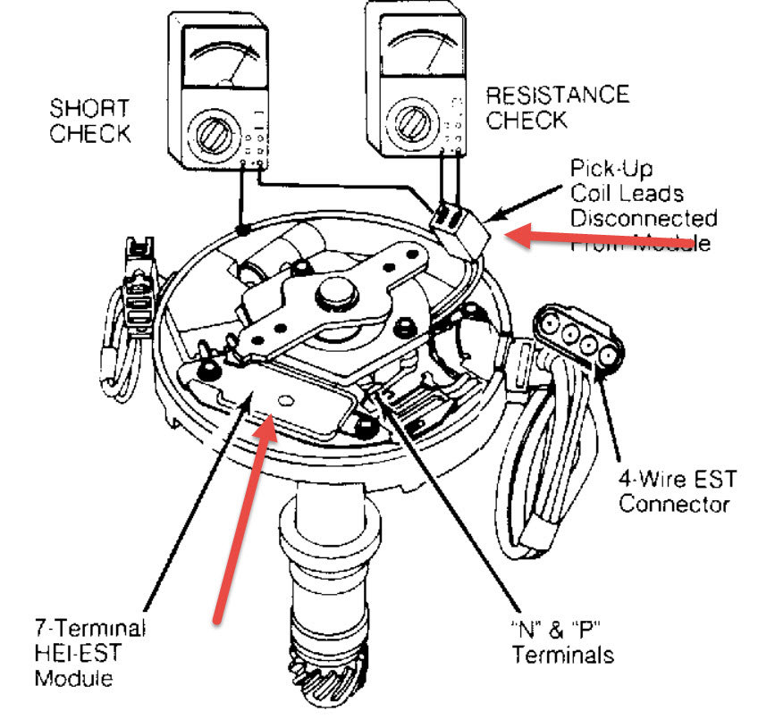

All ready replaced the fuel pump and filter I also replace crank shaft sensor and still does not start. What could be the problem?
Sunday, June 5th, 2016 AT 10:55 AM
6 Replies
JOHN SCOLUM
When I was driving it stopped running. After replacing I those parts, now I have no spark.

See this article also check fuses under hood.

Check fuse 8 for pcm if no spark. Then scan for codes use a paper clip between A and B on scanner plug in below dash under steering wheel. Check pick up coil in distributor see picture must be between 500-1500 ohms. Get codes via flashes on dash check engine series of three. It can be 2 then 1 or 3 then 4 then go to our site here under repair and look for codes for OBD1 pic it will come in next email.

Picture.
