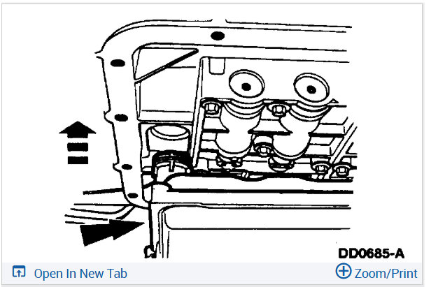

The first thing you should check is the transmission fluid level. Does the vehicle make a grinding sound when putting it in park? If so, you can have a broken axle. Here is a guide to help check the fluid level, also check the images below.
https://www.2carpros.com/articles/how-to-check-and-add-transmission-fluid
If the fluid level is okay let's run the codes to see if any are stored. Please go over this guide:

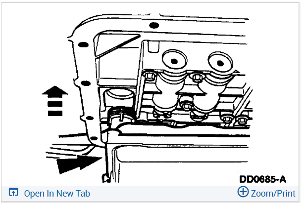

Also, there is a chance the transmission filter has come undone from the pump. Check out the images (below). Please let us know what happens.
