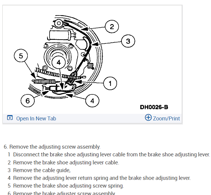

I replaced the shoes, hardware, and cylinder for my rear drum brakes. When i took it on a test drive it started getting hot. One of the shoes is getting pushed too far and won’t go back down, what do i do?

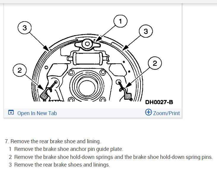

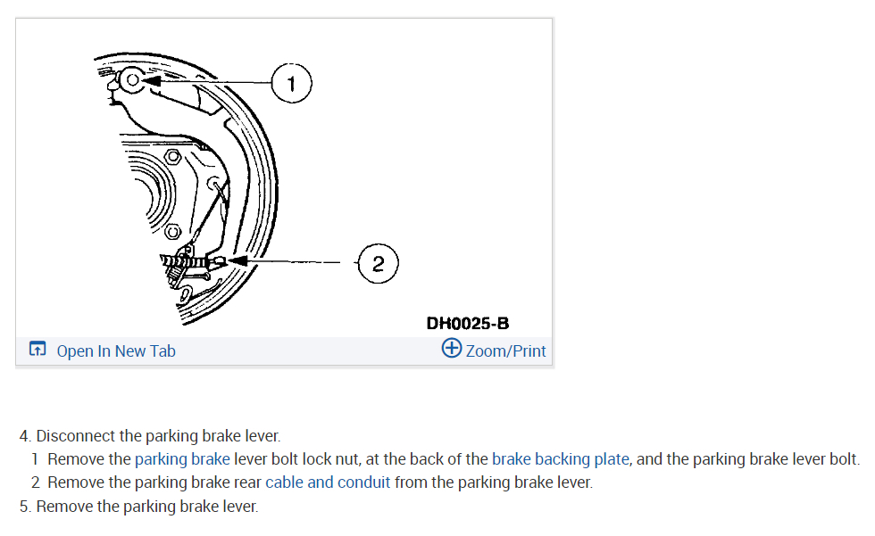

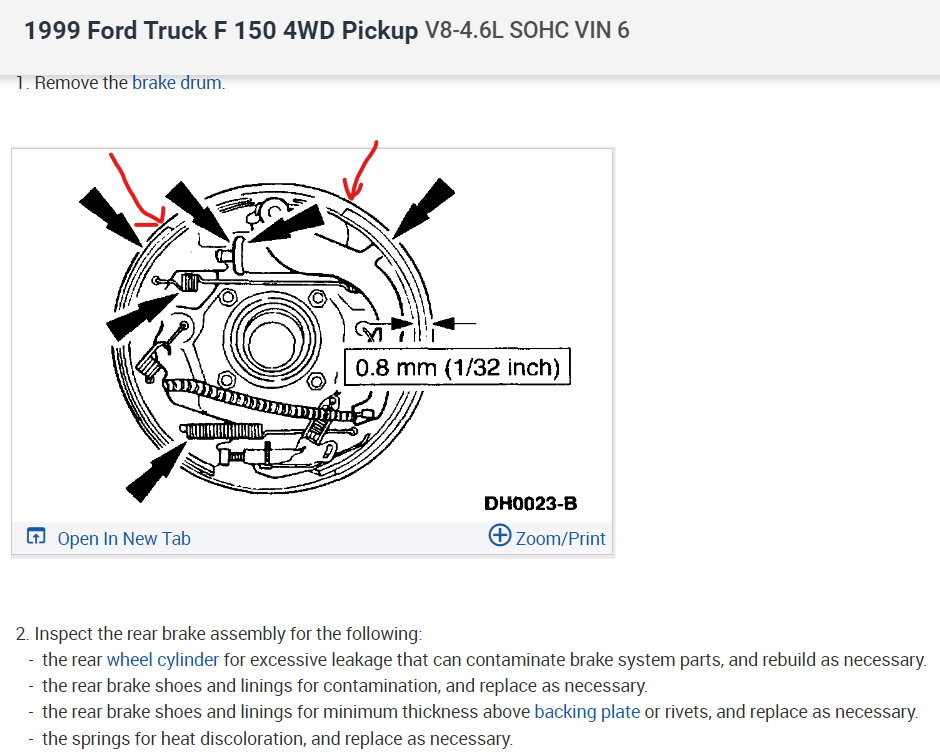

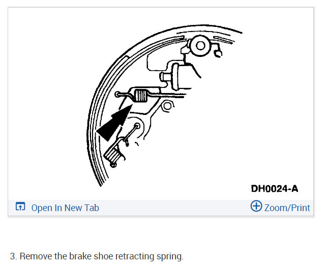

It sounds like you got the brake shoes mixed up, there is a primary and secondary shoe and if you have it in the primary position the brake shoes have a hard time releasing. Here are diagrams in the images below to help you see how to do the job correctly, also I have marked the primary and secondary shoe which has more lining than the primary shoe. This guide may help out as well:
https://www.2carpros.com/articles/a-comprehensive-guide-to-fixing-automotive-brakes-locking-up
Check out the images (below). Please upload pictures or videos in your response of any problems so we can see what to help you with.
