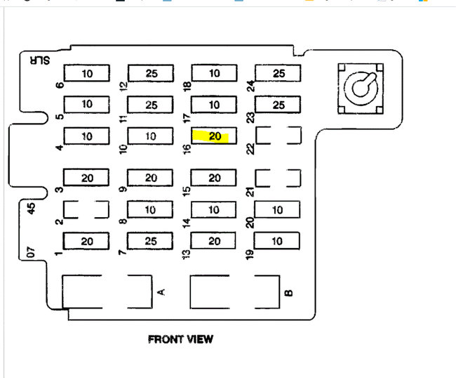

My blinkers and hazard lights are not working.

Does anything happen when you try the signals? For example, do they light but not flash? Or does absolutely nothing happen?
If nothing, first start by checking fuse 16 in the fuse box on the lower left side of the instrument panel. When you check the fuse, first make sure it is good. If it is, then I need you to check for power to it. Here is a link that shows how that is done.
Let me know what you find. Also, I highlighted the fuse to check in the fuse box in the picture below.
See pic below.

How do I see if they have power going to it? The blinkers and the hazard lights don't do anything at all.
checked the fuses they still good.

To check for power, all you need is a test light or multimeter. If you review the link I included above, it shows how to check.
Take a look and let me know if you have questions.
