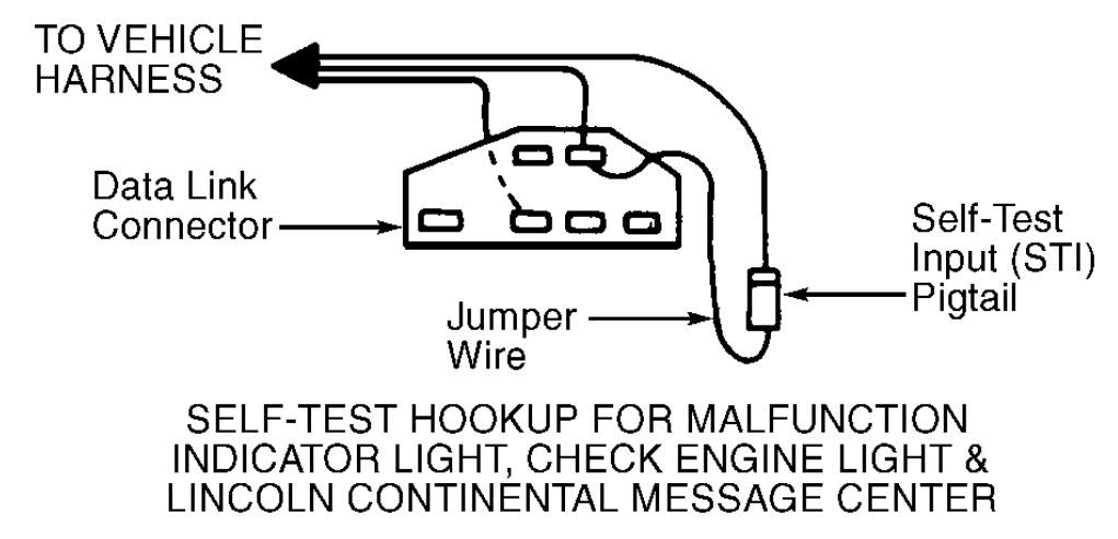

HMAC300
  • 48,601 POSTS
See pic to get codes if any you need to have key on and count flashes on service light. You'll need ajumper wire to hookup at aldl which is at back of engine compartment. I have attached a pic showing what it looks like and where to attach. Get back with codes. One other thing check fuel pressure with a gauge you may need an adapter but most auto parts rent it.

KEN52
  • 38 POSTS
Took the car in and replaced fuel regulator, and pcv and pcv hose.
Showing codes, 173,211,634,639, will see if the replacement gives me better mileage. Hopefully doesn't show code 173 now.

HMAC300
  • 48,601 POSTS
If sure wasn't 30-45 psi at idle then it was either low or high whatever your reading was. With key on engine off should be 35-40. The other codes may have come on when you were trying to fix it, maybe not. Why the car is so hard to fix is because it's OBD1 and over 20yrs old. Lot of mechanics don't want to take the time to look at them because it's ancient technology

HMAC300
  • 48,601 POSTS
634 is manual lever position out of range and 639 is no turbine speed sensor input so check if connected or fell off. 211 is ignition pickup failure so reset computer (pull fuse for ecm) and see if it goes away. The others have a trans guy look at it.
