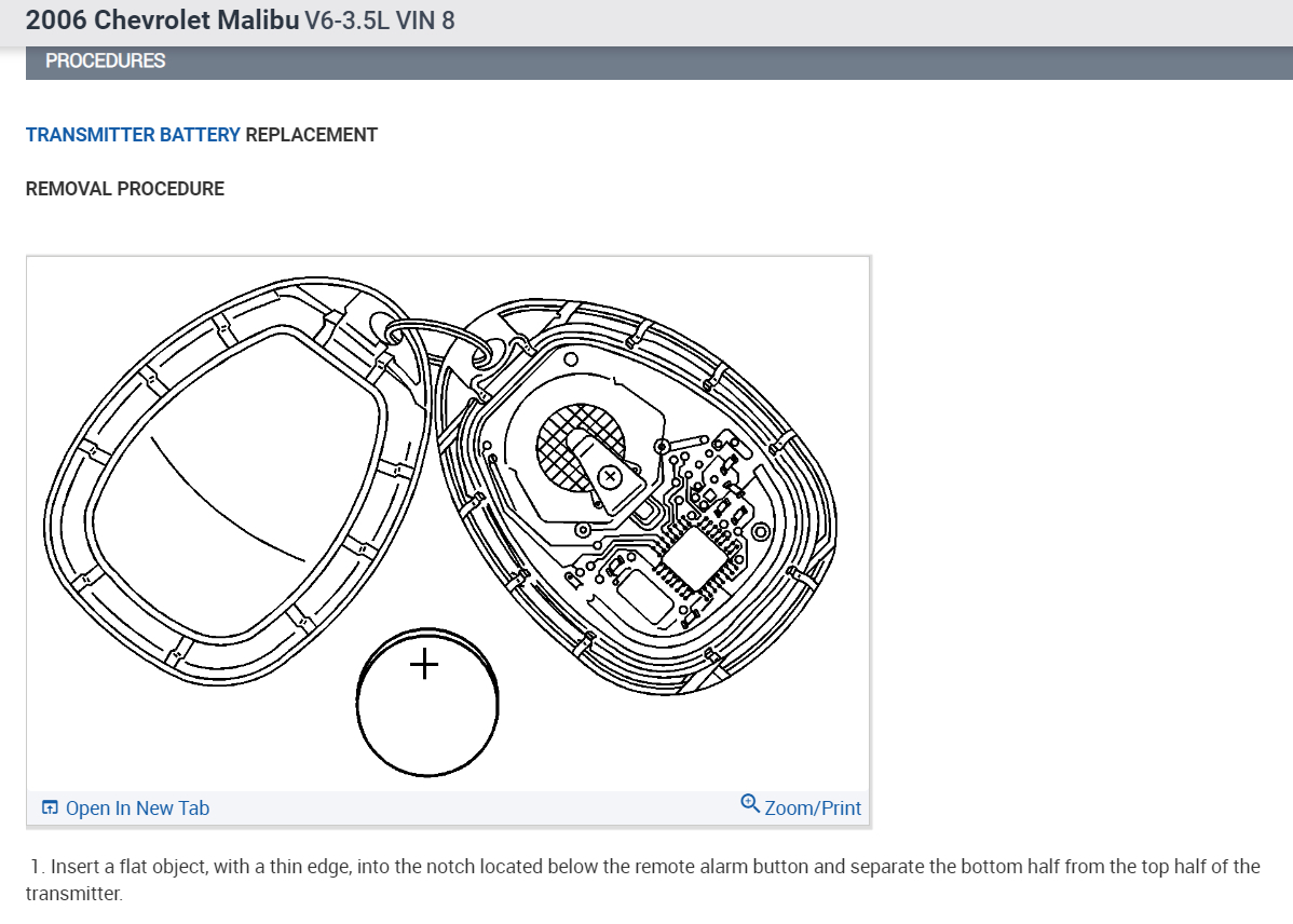

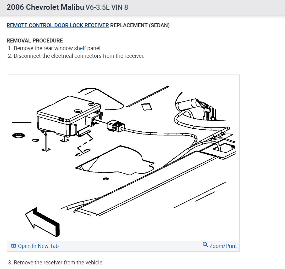

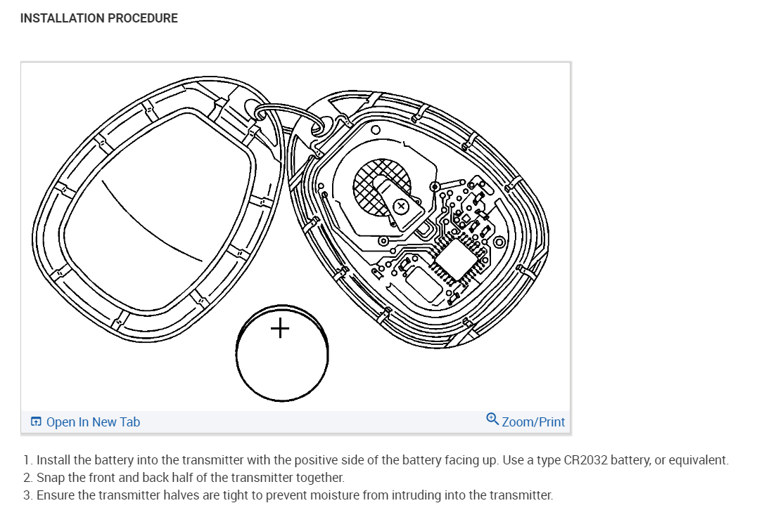

I have two key fobs they lock and unlock the doors start the car and activate the horn, none of those work and I changed the batteries. what do I do?
Sep 9, 2022 at 6:28 AM
  • 55,433 POSTS

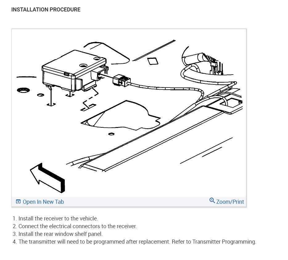

This is controlled by the vehicle keyless entry receiver so if the fobs are not the problem the KER is, but to be sure let's try reprogramming the fobs and do a CAN scan which is easy which can tell us for sure if the KER is the problem, you can get a CAN scanner (Controller Area Network) from Amazon for about $30.00. here is a video to show you how. Also, since the location of the KER is under the seat, they can get wet and stop working. It is worth removing the electrical connector and looking for moisture or corrosion. The location is in the images below.

Well, I checked the KER under seat no problems I purchased the scanner mentioned above Scanner came up with nothing showing for RDLR (but did show I had a sensor out fuel tank). Off subject replace bad check engine light.) Got a programmer scanner tried programming 2 FOB'S Did not work. any other Idea's?

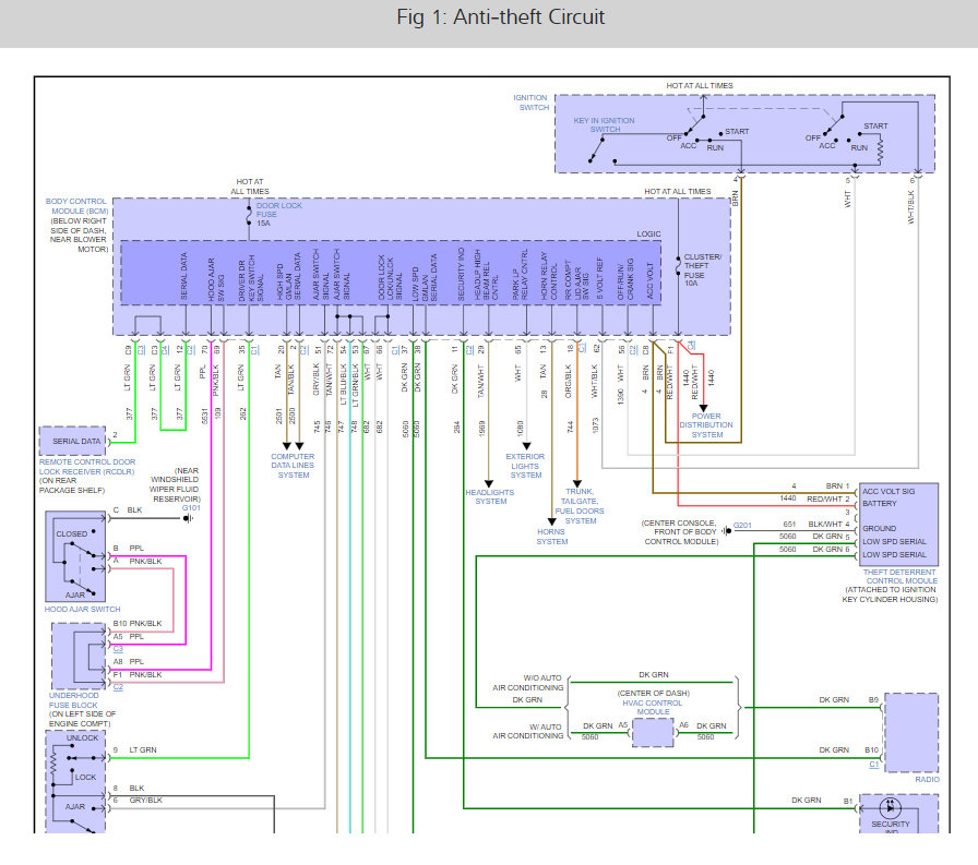

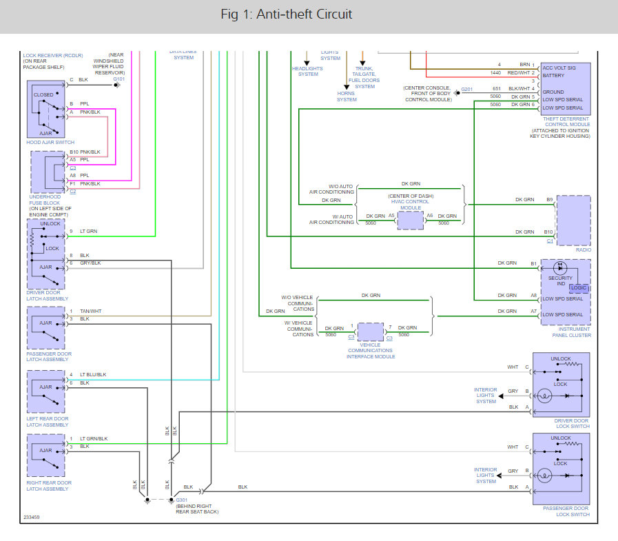

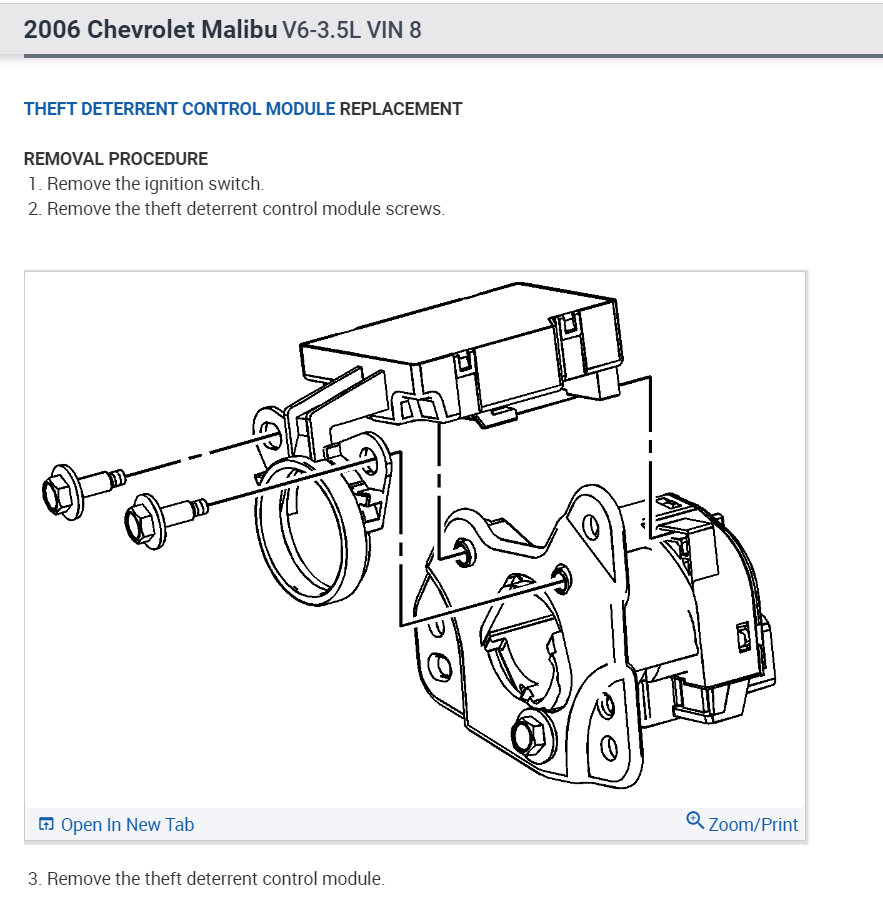

I was hoping the scan would have told us more, it sounds like the BCM is out here are the wiring diagrams so you can see how the security system works.
KEYLESS ENTRY SYSTEM DESCRIPTION AND OPERATION
The keyless entry system is a supplementary vehicle entry device. Radio frequency interference or discharged batteries may disable the system.
Keyless entry allows you to operate the following features:
- The door locks
- The rear compartment lid release-Press and hold rear release button for approximately one second to activate.
- The illuminated entry lamps.
- The panic alarm.
- Remote start.
The keyless entry system has the following main components:
- The transmitters
- The body control module (BCM)
- The remote control door lock receiver (RCDLR)-When you press a button on the transmitter, the transmitter sends a signal to the RCDLR. The RCDLR receives the signal and sends a X Link serial data message requesting the appropriate function from the BCM.
