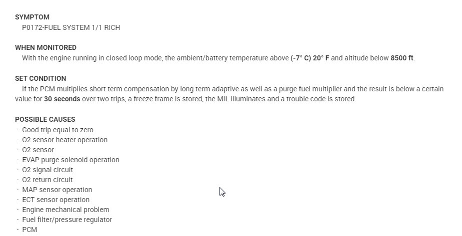

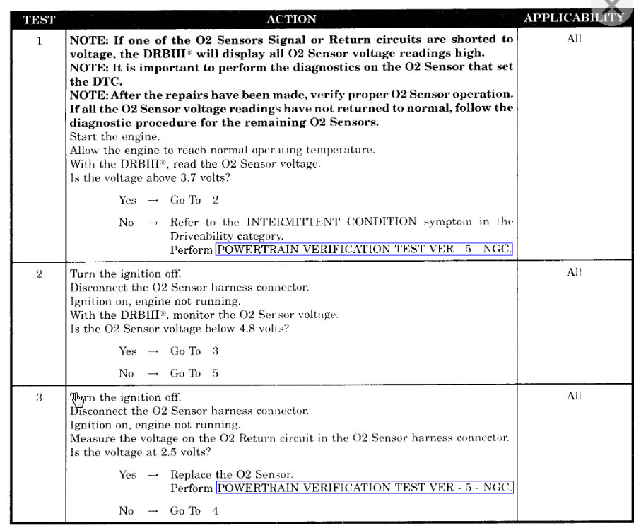

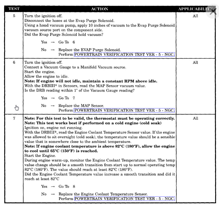

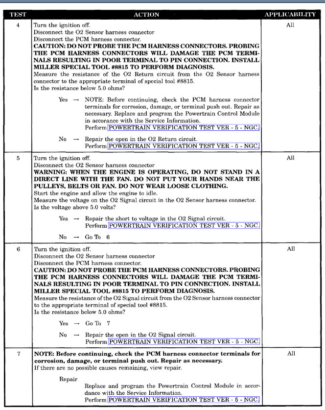

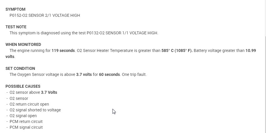

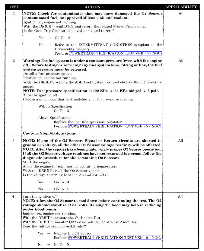

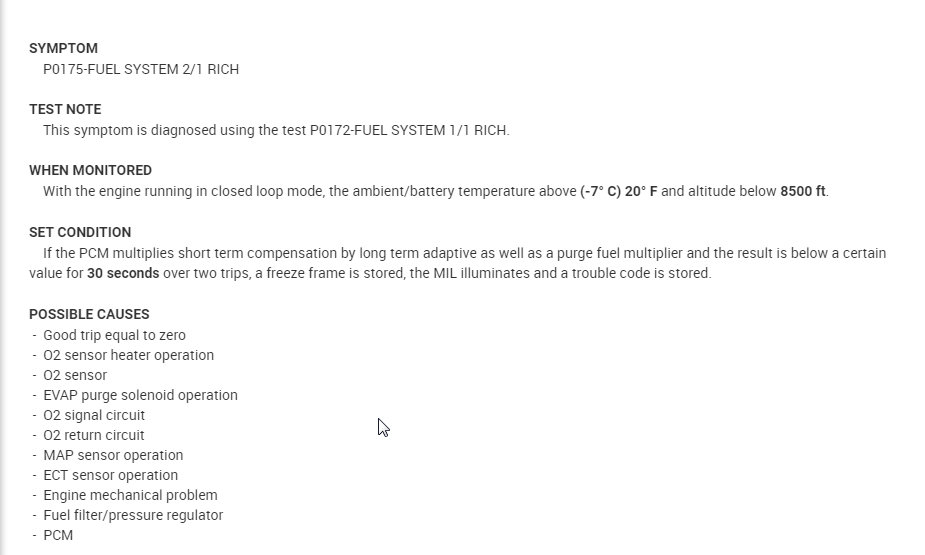

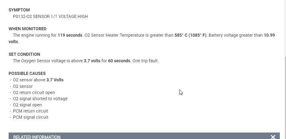

I believe i wasn't clear in my question. In order for the stall to pass I have to go to full throttle a few times. Then car will run fine after that. I put scan tool on and have these codes: p0175, p0172, p0132 and p0152. Which I think may have something to do with replacing o2 sensors?
Jul 27, 2020 at 9:16 AM
P0132 - o2 sensor circuit 1/1 voltage high
P0152 - o2 sensor circuit 2/1 voltage high
P0172 - Fuel System 1/1 rich
P0175 - Fuel System 2/1 rich

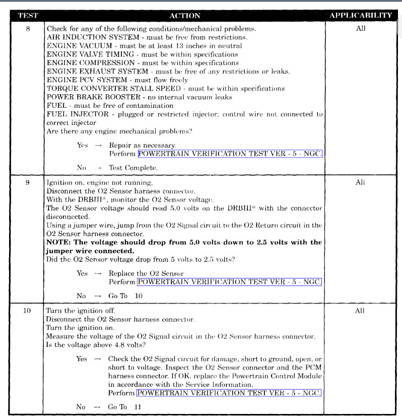

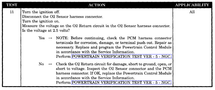

These codes are basically saying the same thing. They are both showing that the fuel system is rich. So we need to run through the testing that I attached to figure out what is causing it.
Let me know if you have questions and we can go from there. Thanks

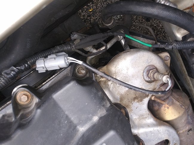

Thank you for your reply. I opened the hood yesterday and the left o2 sensor looking from front of car the black wire broke loose from sensor.
Should i just replace all 4? And which side is upstream and which side is downstream?
Jul 28, 2020 at 12:40 PM
Can you get a picture of what happened? If the wire is loose then you need a connector or wiring harness and not the sensor. The upsteam is in front of or before the converter. The downstream is below or behind the converter.
Let's get a picture and go from there. Thanks

I got rid if the old sensor and replaced it with one that came out of the bad engine. Here is the pic. It's the black wire that was frayed and broke off the top of the sensor.
Jul 30, 2020 at 2:24 AM
So you replaced the sensor and pigtail with one that was okay? Sorry, but I don't see where the wire is damaged. Maybe get a closer picture of the damaged area. However, this wire can be repaired as long as you have enough slack on both sides to solder them back together.
