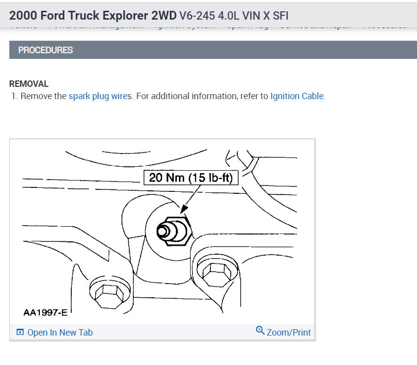

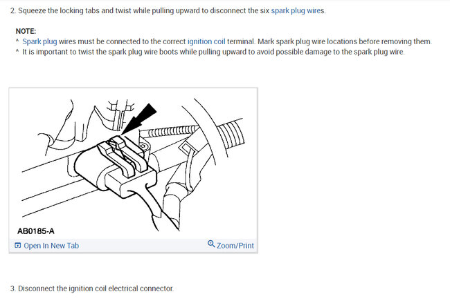

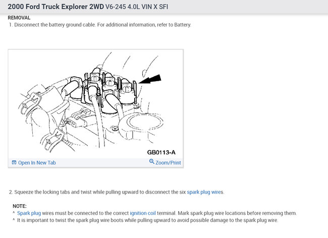

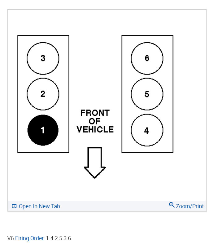

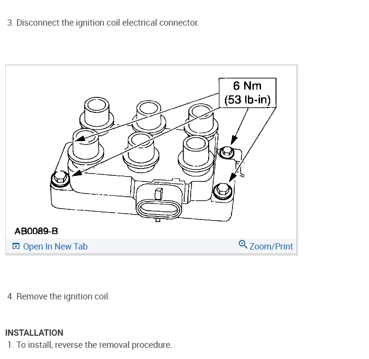

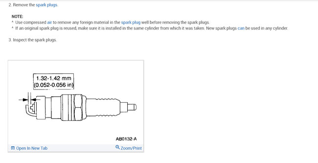

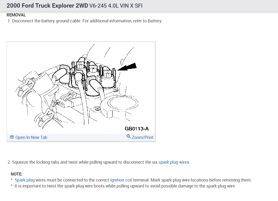

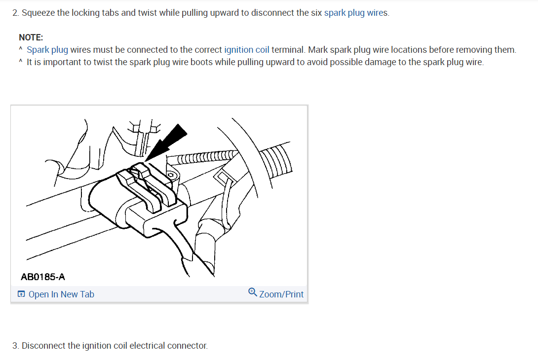

This is common when the spark plugs, plug wires and coils need to be replaced. Here is a video to show you how to fix the problem which is done on a similar engine, but the procedure is the same and I have provided the instructions for your engine in the images below.
https://youtu.be/e68QXyBAiZo

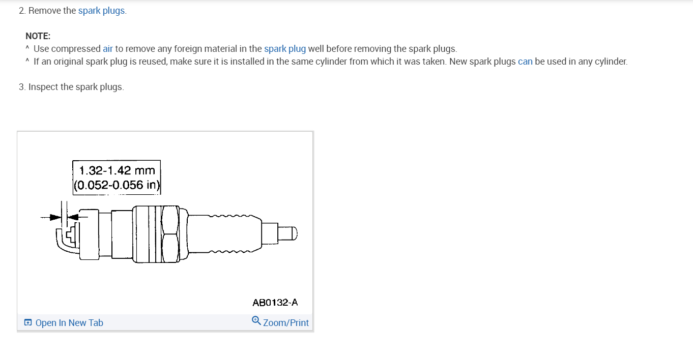

RH Original Spark Plug Type .................... AGRF22PG
LH Original Spark Plug Type .................... AGRF22P
New Spark Plug Type (Either Side) .................... AGSF22PP
20 Nm (15 lb-ft)
Check out the images (below). Please let us know if you need anything else to get the problem fixed
