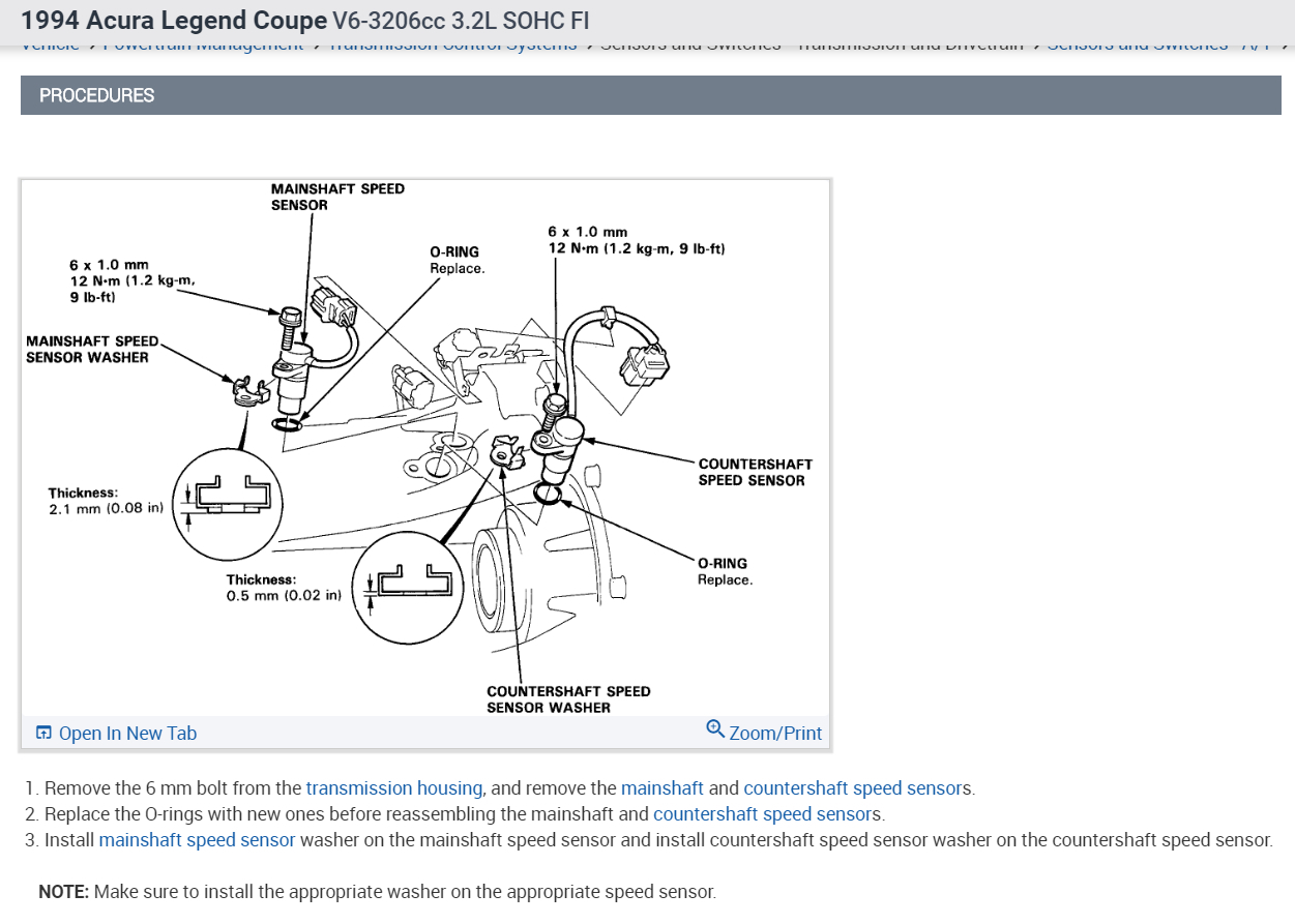

Speedometer is erratic and D lite flashes

It sounds like you have a vehicle speed sensor (main shaft speed sensor) that is going out. here is the location and instructions in the diagrams below on how to change it out. Check out the diagrams (below). Please let us know what happens.
Image (Click to enlarge)
