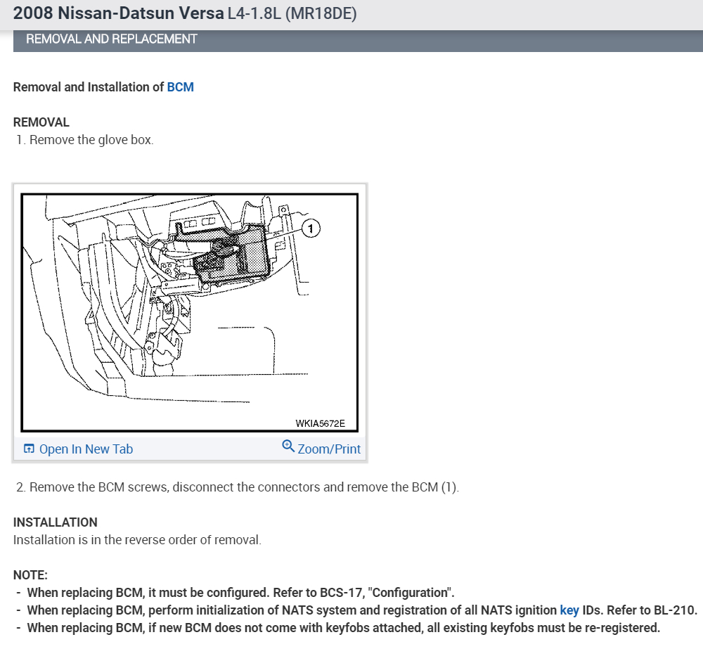

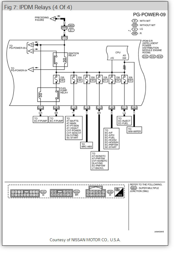

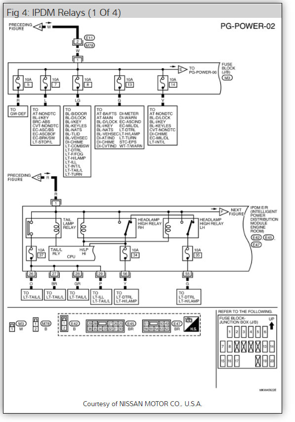

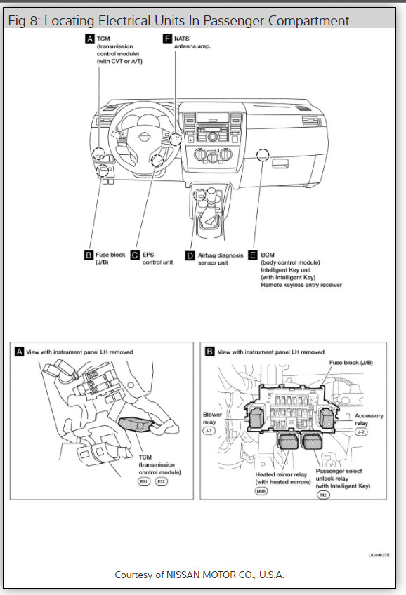

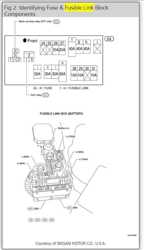

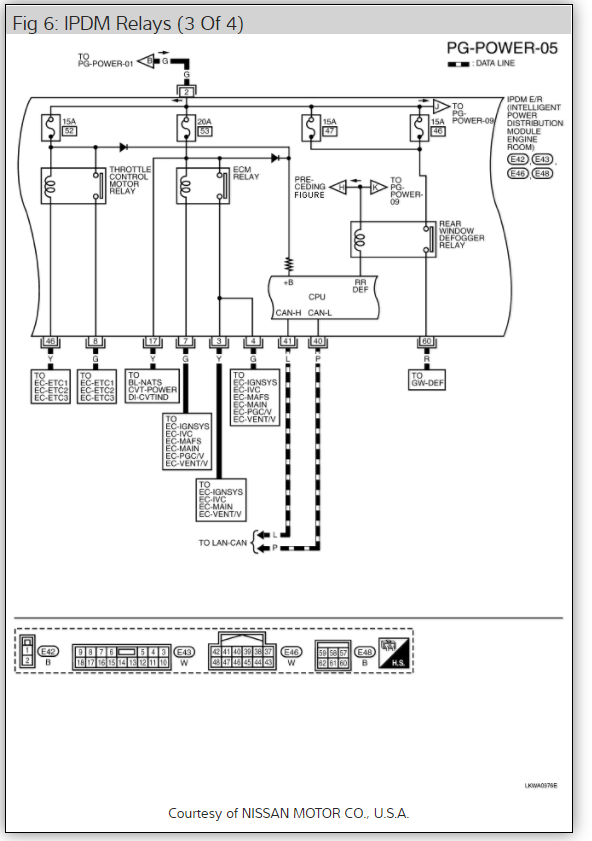

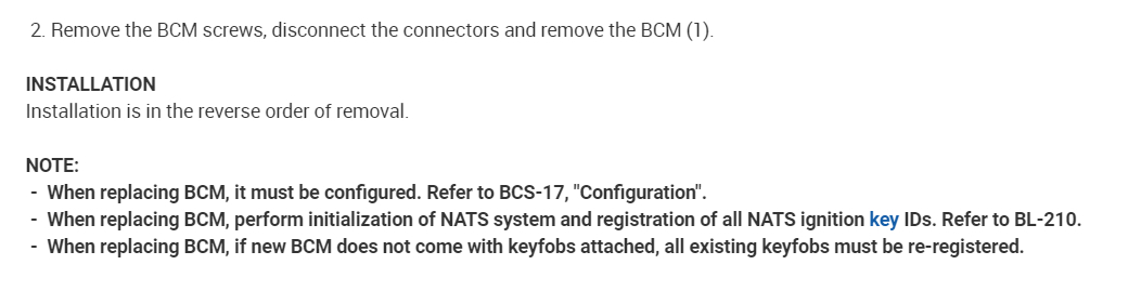

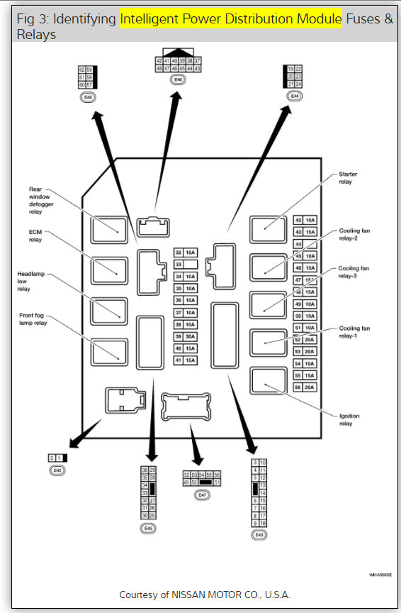

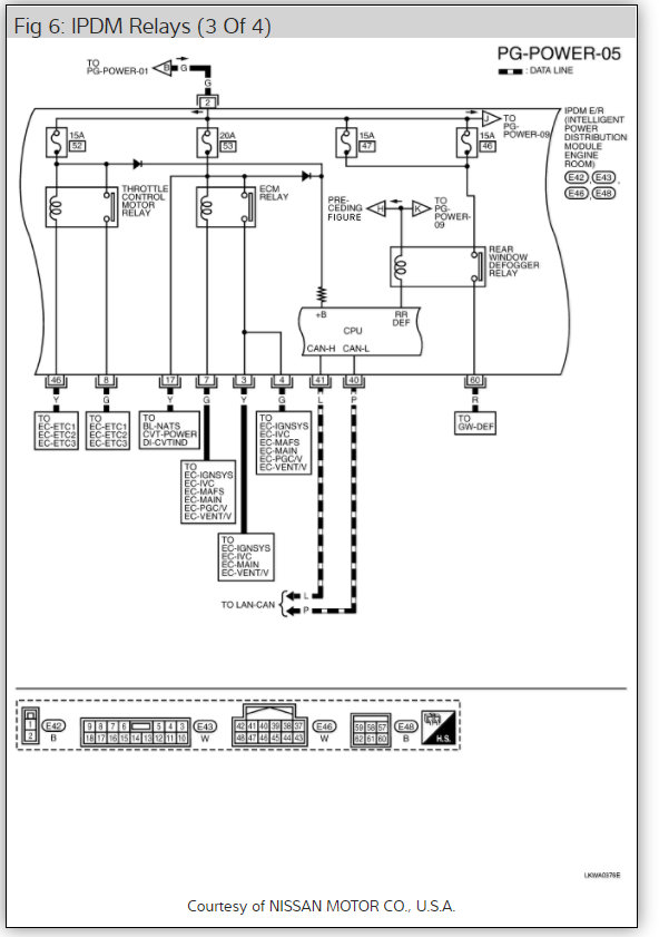

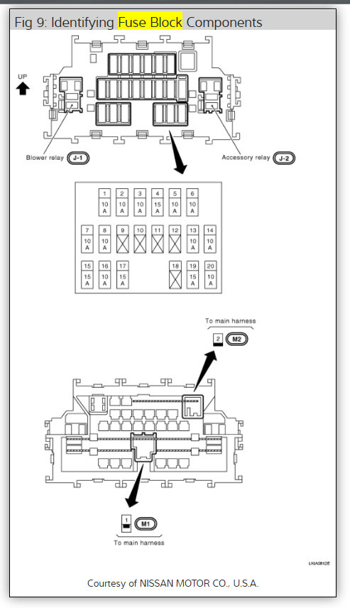

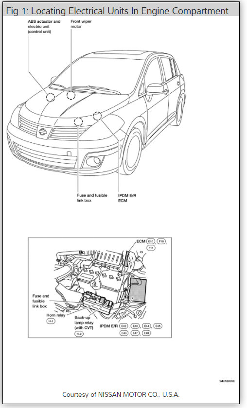

I would start by checking the fuses because the BCM doesn't sounds like it is working and may need replacement. Here is a guide to help you test the fuses and the fuse location as well in the diagrams below. I have also included the BCM replacement instructions.
