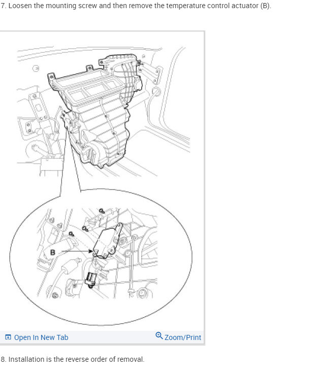

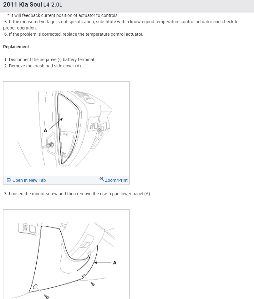

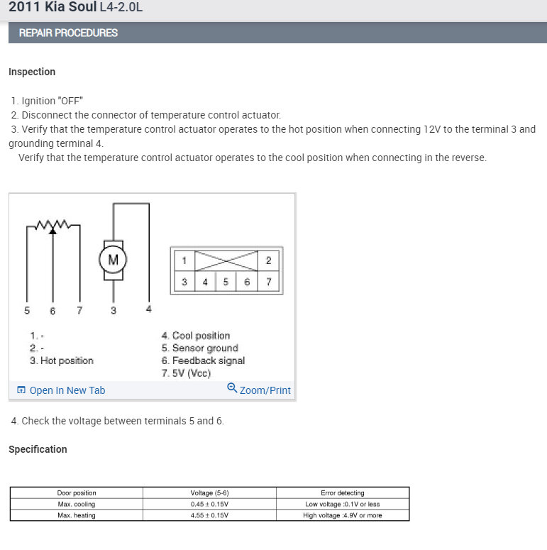

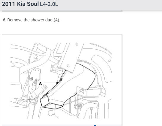

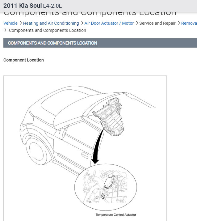

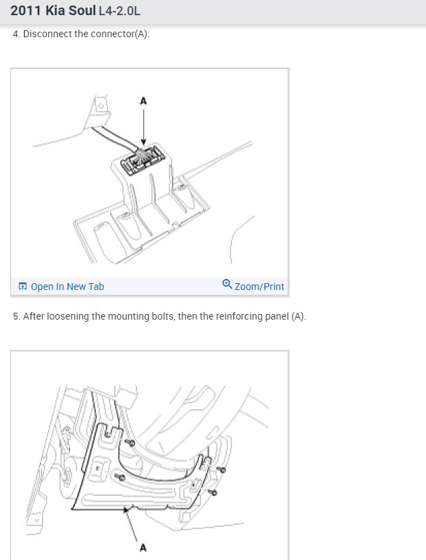

So, does it blow cool air when the heater is on?

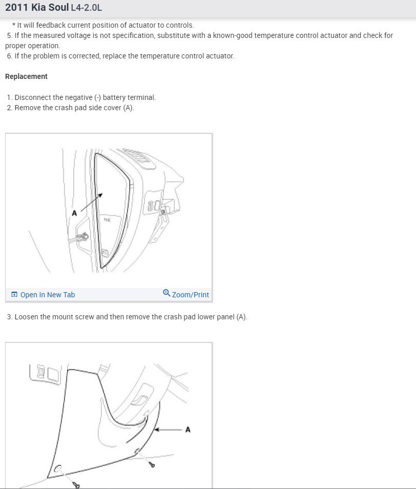

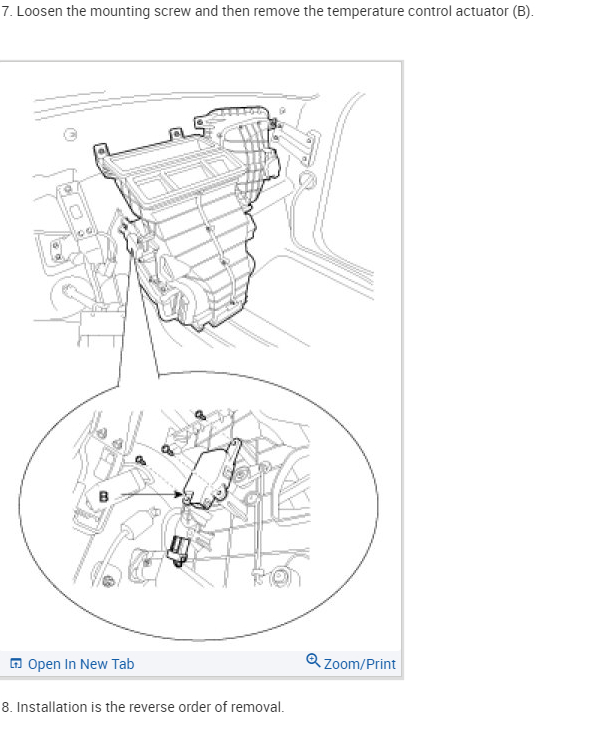

If that is what you are experiencing, then it could be a faulty blend door actuator.
That actuator is what controls the cool and hot air flow mix. It can fail and get stuck in one position.
Take a look at this helpful guide:
I have attached the blend door actuator replacement procedure below for your reference.
Let me know if you have any questions.

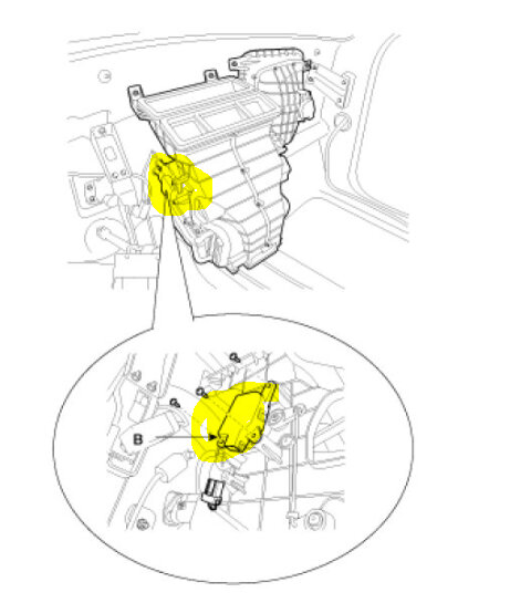

The only thing I can think of would have to do with the blend air door. It's possible the actuator is failing, and the door is moving a bit.
The blend air door is what determines the air temperature entering the vehicle, hot or cold. You may want to confirm it isn't loose.
It is located under the dash and mounts to the HVAC box. There are three screws that attach it. See pic below.
See pic below.
